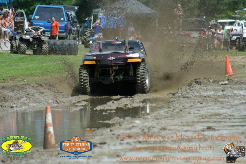

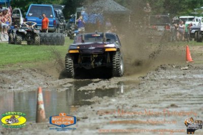

This is a Monster SS TH350 . Built for mud drag racing. I have been running it hard for 3 years . It has a full manual reverse valve body With trans brake,4,500 stall FTI converter. I spray 250 hp NOS Fogger with a BBC 454 somewhere around 800 hp.
