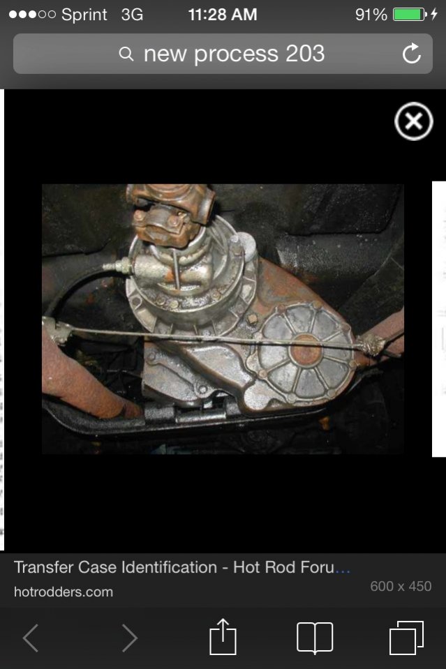

Ok. It has 5 shifter positions. Locking hubs. Did find numbers on the case as well. Looks like a 203 from pictures I have seen
Feb 25, 2014
39
prattville al
nathan
Looks like this
Feb 25, 2014
39
prattville al
nathan
Only that hose thing is on the right side. I'll see of I can upload one of mine. Everytime I try it says the file is to big
