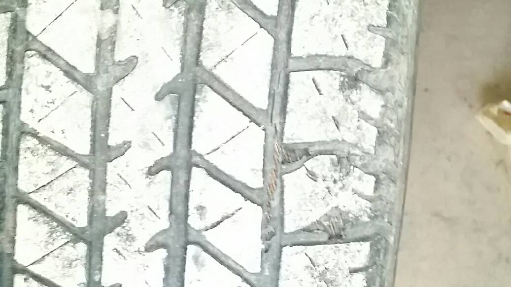

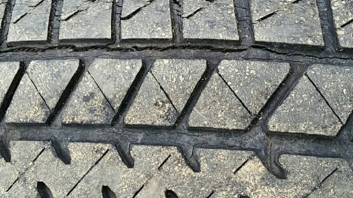

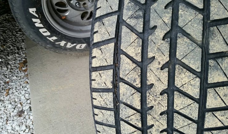

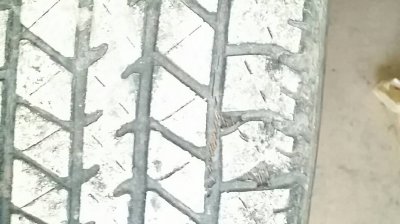

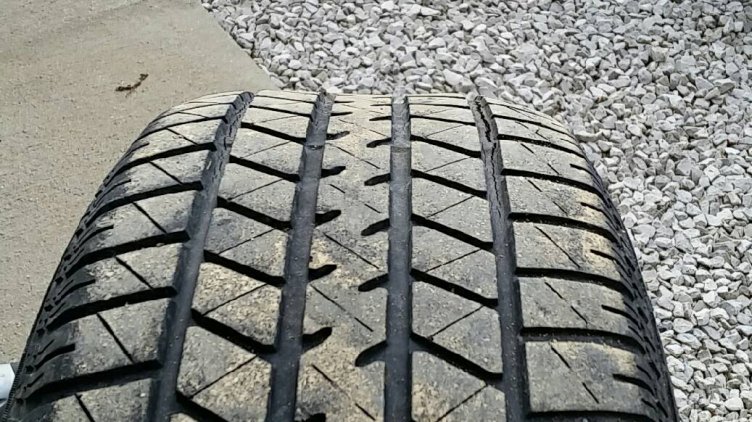

Well bucket you were correct. Both back tires are coming apart. Looks like she's going to need new shoes.
cjkirby55
Jan 22, 2012
132
18
Indiana
355
The damage...

They must be fairly old, I haven't seen a set of those in a while.
cjkirby55
Jan 22, 2012
132
18
Indiana
355

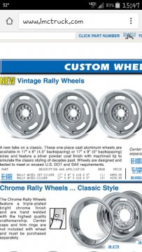

The Daytona's were on my truck and I bought them new in 04. The Burb came with Mastercraft Avenger GT's. No idea how old they are but they aren't long for this world. I think this is the solution.
