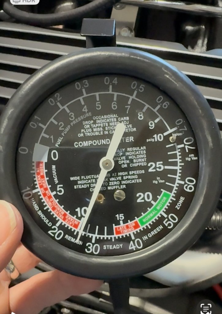

How much vacuum is the engine making and how much at the modulator? Also check the governor gear as Matt suggested - make sure the gear isnt stripped. If governor is fine and vacuum is sufficient, call the builder. Could be valve body or issue with the intermediate clutch itself.

The engine runs 10-12” when warm.
