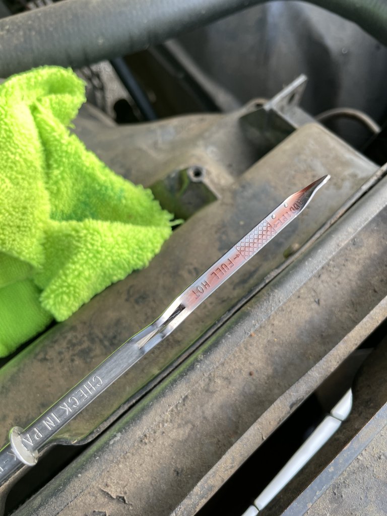

When I checked it this morning it was perfectly at the full hot line but now appears to be overfilled even though nothing was added?

first off I think you have overfilled the trans. The level on the dip stick should read one pint low when cold and idling in park.Once driven and warmed up, it should read full idling in park.Put a vacuum gage on the hose at the modulator and check for vacuum.Some models use a restrictor in the fitting on the engine side to soften the shifts.It could be plugged.Governor pressure overcomes modulator pressure to make a shift.Recheck the governor by moving the weights and making sure the valve in the center moves and isn’t stuck.
