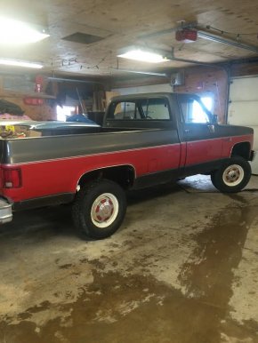

Hello, I'm looking for any info on switching in a 454 multi port fuel injected engine from a 350 tbi. The 350 is original to the truck and the 454 is a slightly use crate engine. the 454 comes with all the sensors & ecu.
Just wondering what issues there are with the fuel system that will need upgrading. Will the pumps need to be changed [dual tanks ]? Any other suggestions would be appreciated.
