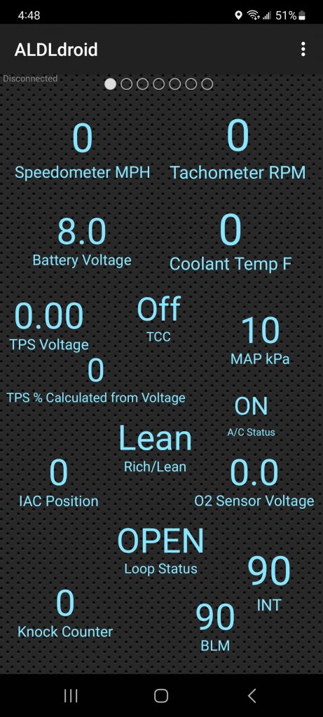

What info does the ALDL see? Can you see live info and make changes or just read codes. First I'm hearing about it. Kinda new to TBI, went from a 76 GMC to a 2002 2500hd which I had HPTuners and did all kinds of stupid stuff with. Now I'm going back......not a fan of new stuff. Way too much money for a quicker dying vehicle.
you see most key parameters the engine sees.
here is my main home screen in ALDLDroid
