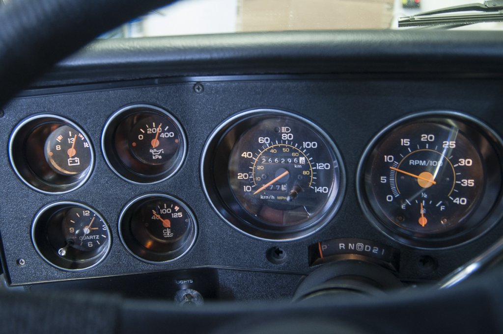

Last summer I replaced the big gas gauge with a tach and moved the gas gauge to where the clock was.
I tried to order the "kit" to do this from LMC. It was backordered for 6 - 8 months. I finally got tired of waiting and ordered all the individual pieces which "amazingly" they had. Paid about $100 more than the "kit" price. I ended up having to get the back panel also as the new, small gas gauge didn't mount in the place where the clock was on the old one.
You will need the correct printed circuit for sure.
I have pics and can list the items I bought if anyone needs it. I have an '83 GMC Sierra Classic SB.

Here's the list of parts I ordered from LMC.
My truck is an '83 GMC Sierra Classic. Parts differ for other years.
This process isn't too hard to do. I removed the dash pad, helps a lot.
Make sure the speedo and tach wires go in correctly so you don't have to remove the cluster after installing it. (Lesson learned)
I used some Testors model car paint for the older gauge needles.
I also, used a small rubber plug for the hole in the lens when the clock stem was. Just to keep dust out.........
36-2042 Tach - 7,000 RPM
36-3104 Tach wiring harness
38-8069 Tach bracket (didn't need it)
36-1858 Small fuel gauge
38-8101 Gauge cluster backing plate
38-8041 Printed circuit
38-1103 Dash bezel - brushed aluminum (handle with care or it will crease very easily)
36-0190 Instrument bulb holders - as needed
38-8042 Retainer clips for printed circuit - as needed
As for the clear lens over the gauges, I polished mine and it looks fine
There's other items you may need like spacers, clips, screws and headlight lens, etc.
Hope this helps !

I've been eyeballing the LMC kit but it's been out for months. I had them send me the parts list and I built it in my cart where I realized it would be almost $200 more doing it this way. I went as far as to buy a set of used gauges to try and rebuild what I had. However, what I got was for a different year than I needed as when it arrived it had a mechanical oil pressure gauge. I'm at the point now where I just want gauges back and will probably skip the tach conversion to do a like kind replacement, but will definitely NOT be reconnecting the clock as it is a parasitic drain that I don't want to deal with

I did a complete bezel swap on my 74 K5. I found a guy that had a 73 suburban with a newer model cluster in it. BUT, the problem I am finding with getting things used is the plastic is so very brittle and can break off in a heartbeat when putting things together. Many companies sell the Cluster Backing Plate but never the one you need and LMC does too, but not all of them. So I highly recommend the LMC kit because all of the plastics are brand new, as well as the print out. Things will go in and seat perfectly and be solid for years to come. Thats my 2 cents.
