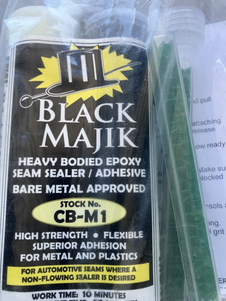

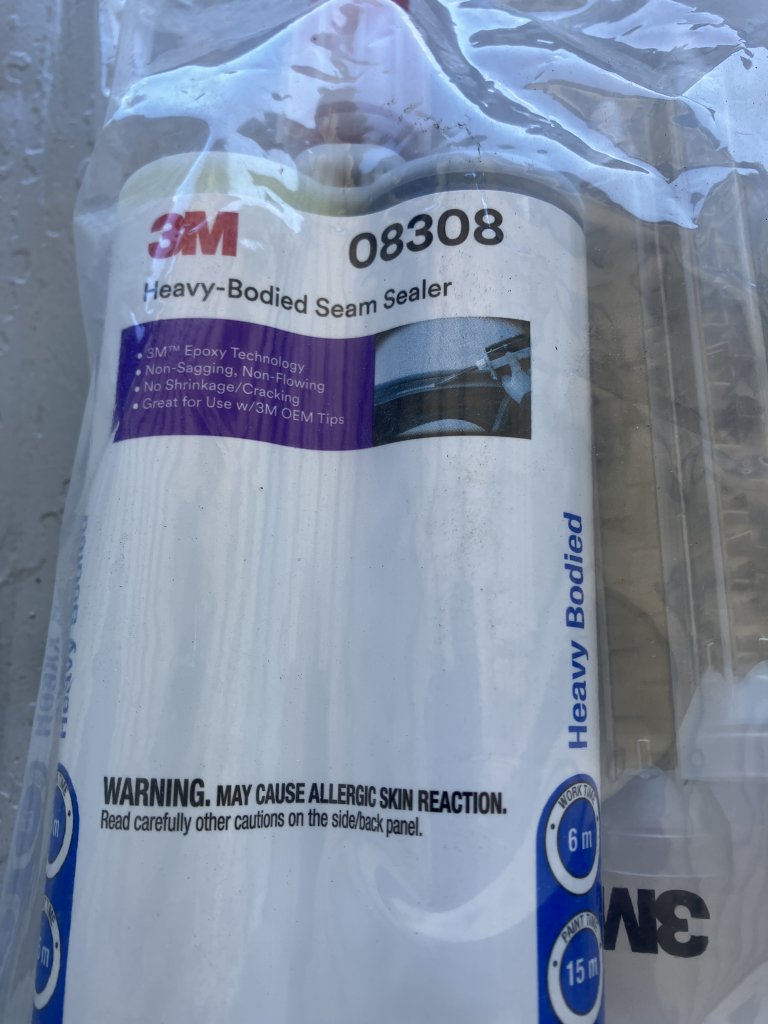

I am in the seam sealing stage on my build. Do not cheap out. I use two brands. Crest Black Majik, and 3M. both are two part, flow great and will last a very long time, around $50 bucks.
And I’ve used Dynatron, ACDelco branded and Sika in the past. All one part (polyurethane). Also work well and durable. The 86 has a tube of Dynatron and a tube of AC Delco on it.
Sika flex and Master Builders NP1 are often specd interchangeably on public works project plans and specs. All good stuff.
