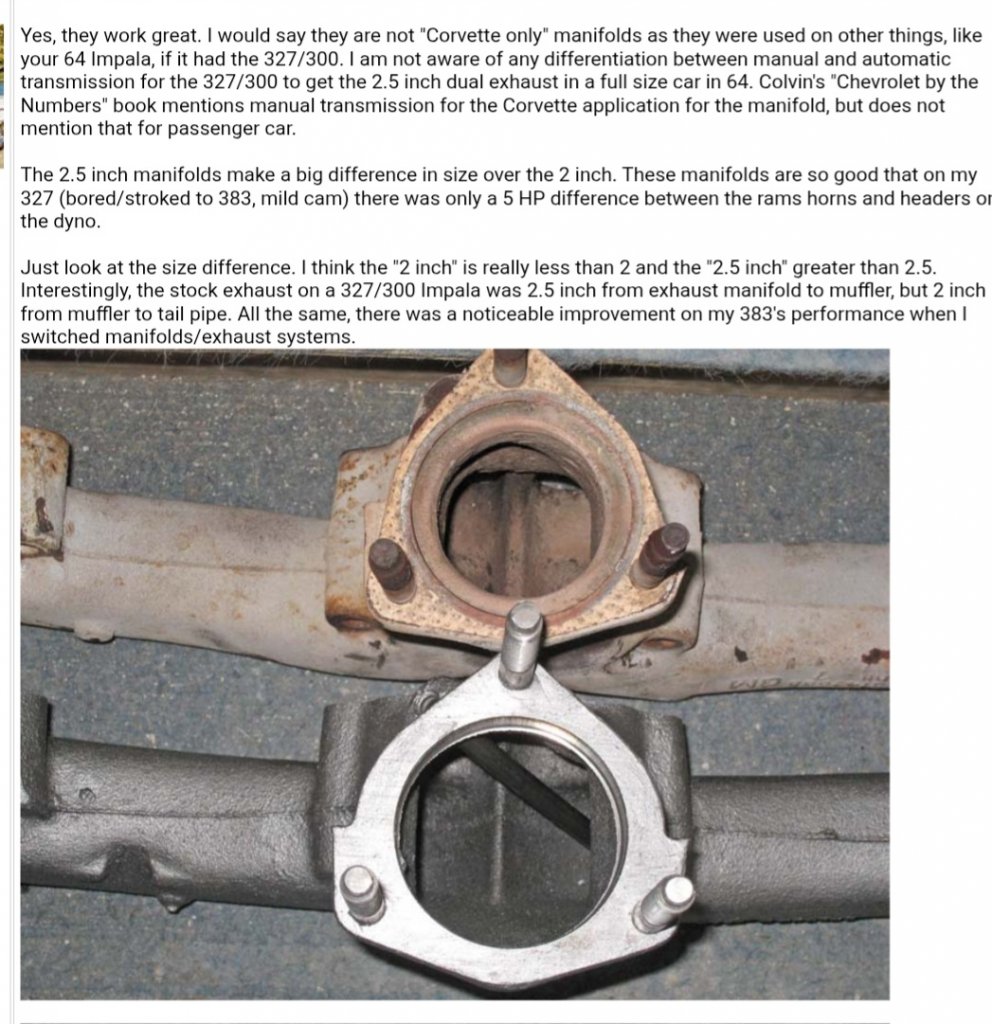

The performance Rams horns won't work on a square,if that's why you were going to rams horns. The ones you want for performance are 2.5 diameter and shoot straight down. The angled Rams horns are 2 inch.

^^^^ 2.5” are the only ones worth while

The only reason for the common belief that ram horns are better is due to the 2.5” ones pictured above from a H.O. 327 Corvette. The vast majority of ram horns out there are no better than any other manifold.

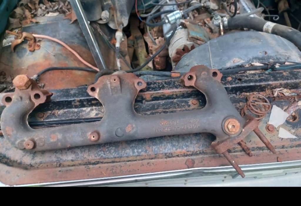

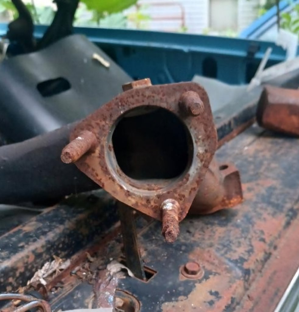

All Vettes weren't 2.5 some were 2 inch 2.5s didn't only come on vettes they were on the hp model sbc's Pics of both center dump rams and pic of a vortec truck manifold I picked up,I'd also look at lt 1 and 90 up Gbody vans as you can see the vortec I grabbed is 2.5 inch
