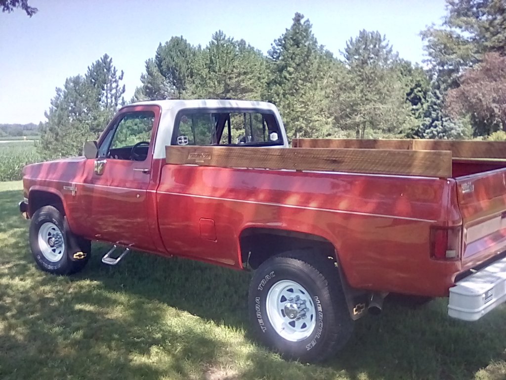

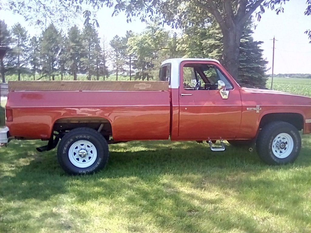

KXKID

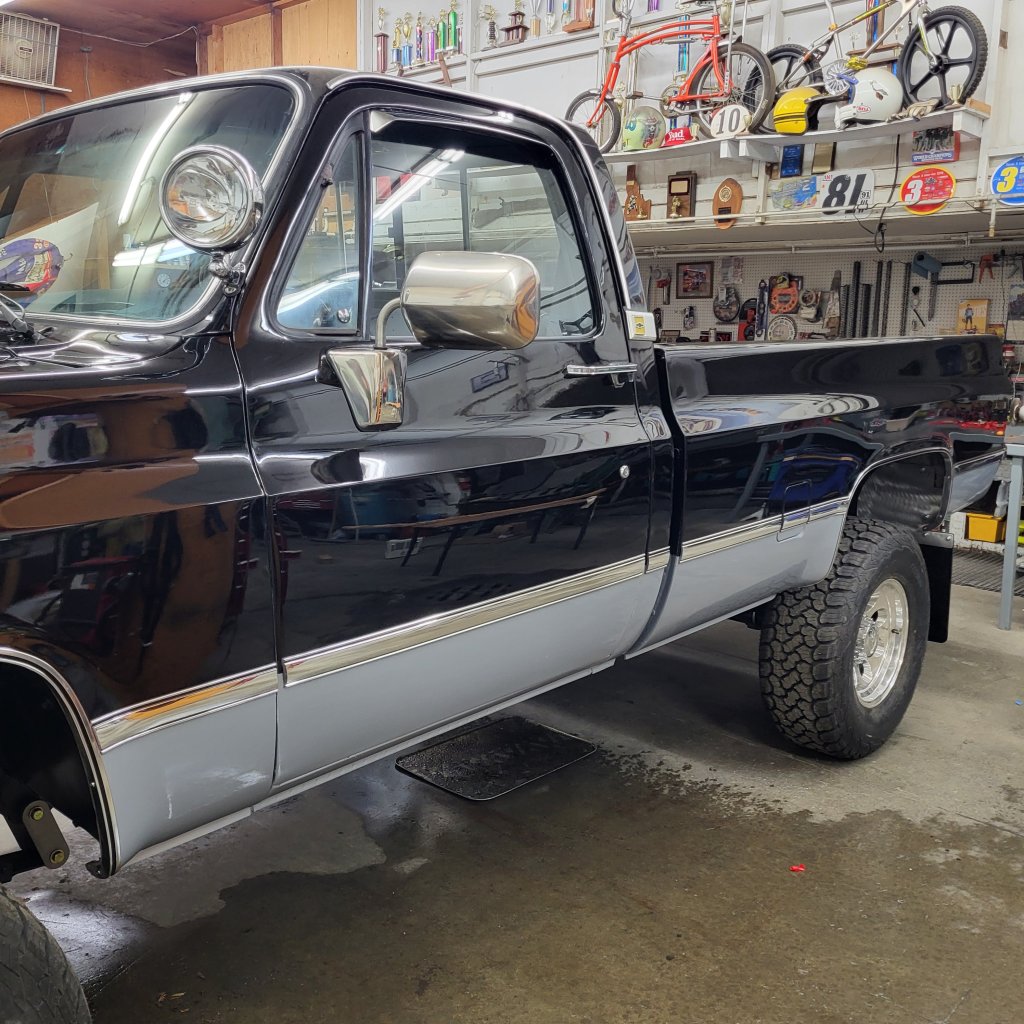

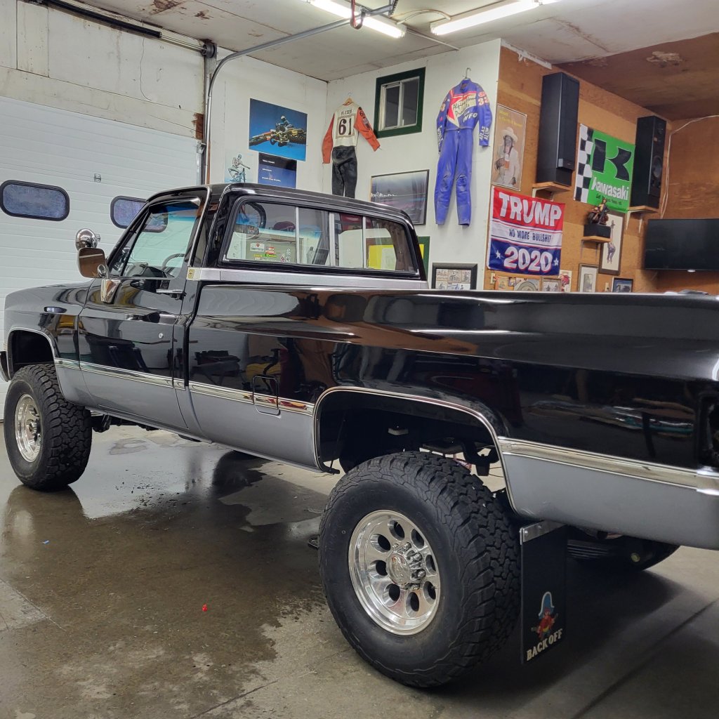

I put a set on my K20 for my wife. They work quite well. Didn't want the ole' running boards.

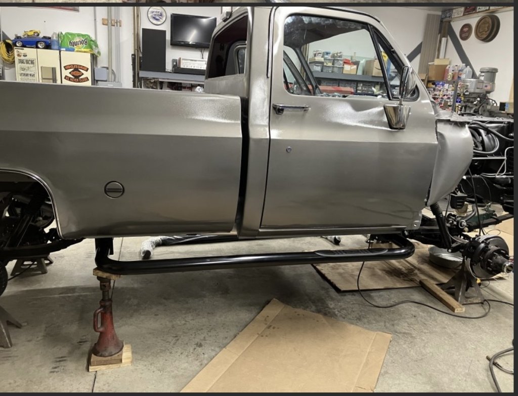

I couldn't find many choices for Squares when I was building mine.
I decided on these, not loops though.
These are sold by Aries(?)
They aren't bolt on, it took some pretty extensive fab work.
