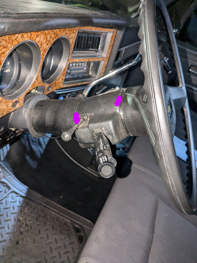

What's up guys,
...when I turn my steering wheel to the right I'm hearing a screeching sound. It's not coming from none of the front end parts. I had all that lubed up. What could it possibly be?
Also, my steering column on the inside of the truck is loose at the neck by the tilt linkage and near the steering wheel linkage. Everything has been tightened on the inside but those areas are still loose. What do y'all recommend?

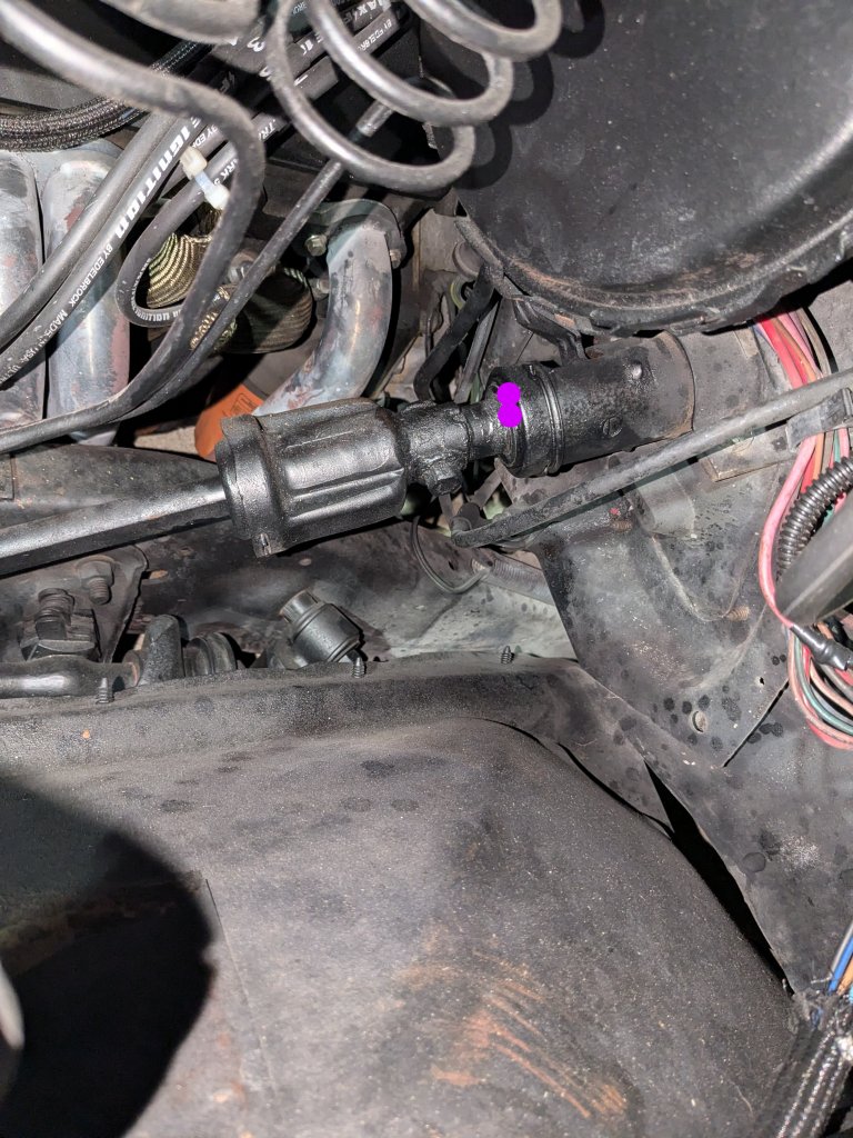

1st image is area of screeching noise
2nd of column looseness

Picture 1, that is a bearing that loves to get drier than a popcorn fart and make noise. It looks like its riding in its plastic housing good (no excess gap I can see) so it's probably the ball bearings part without lube. Number 67 on the blow ups. Might get lucky with some spray moly, I used 10w40 on mine from a pump can.
Picture 2 is probably number 43 x3 loose. That will require a bit of digging in, this would be the perfect time to replace a defective turn signal switch if needed. This job is one you can do with the column installed.
That's how I see it. Well, those things are what I would check first.

An example of the lower bearing and it's holder not being properly spaced. I ended up tapping the shaft (and the bearing) towards the steering wheel to take up the gap (the shaft has a collapse feature that can get out of adjustment).

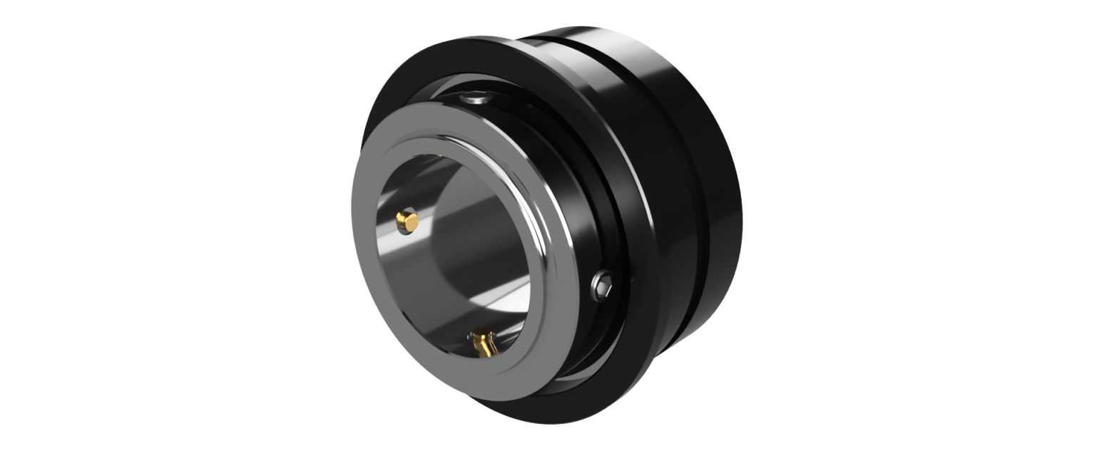

Agree with Radiohead. Just tightened the screws in my column last weekend. Made a huge difference. Before you could move the wheel all over. I am about to change the lower bearing in mine. It’s not making noise, but I can tell it’s wore out. Here’s what I have found that I am replacing it with.

That is way overpriced. Crown, that makes all the repo Jeep parts, makes that bearing kit, as MANY jeeps used GM columns. You can get that kit off the bay or amazon for around 32 bucks, delivered.
I agree, it is expensive. But, from what I have read, it is way better than the stock replacement. Guess I need to do some more research to decide if it’s actually worth it or not.
Well if you are not a rock crawler or serious off road racer, don't see the need when stock ones last 20 years or more. But is your cash.
