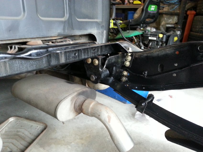

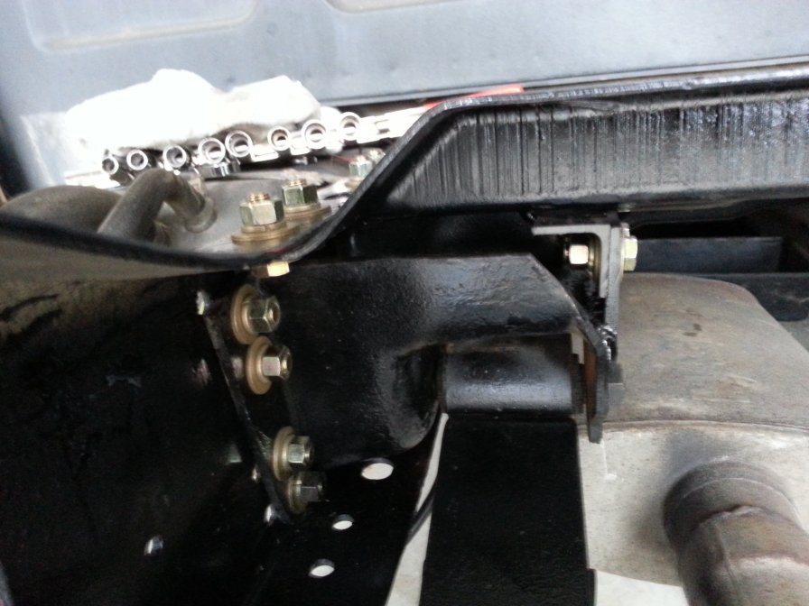

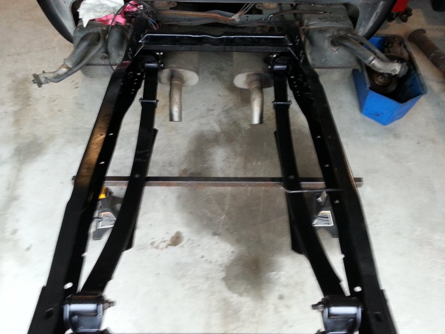

I tubbed my 82 with the stock hangers. I moved them inside the frame and up 3in.
