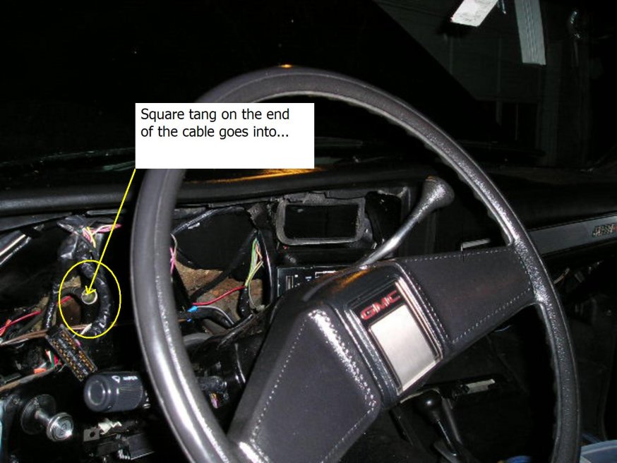

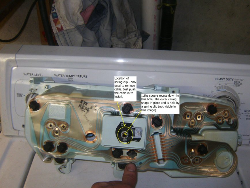

How to hook up speedometer cable to speedometer
Like this:
