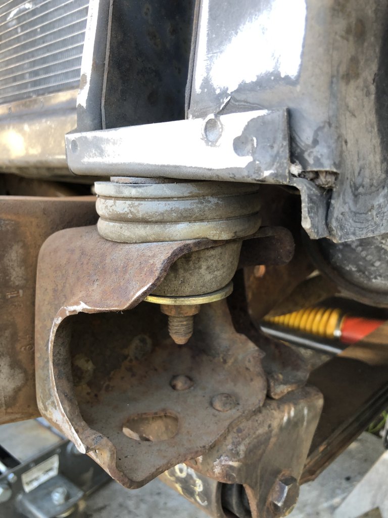

Should I change these while I’ve got it broken down this far ?

Thoughts guys

I've seen worse. If you do them, buy all six. Jack one side at a time after removing the nuts. The other side with the loose bolts will keep everything in line.
Disconnect the distributor cap if it is real close to the firewall. Make sure the fan doesn't hit the shroud. Most important, disconnect the shifter linkage from the trans (auto trans and 3speed) before jacking the driver's side.

It wouldn't hurt since you're that far in

Thoughts guys
FWIW, those are not factory mounts. Those are already Energy Suspension Poly mounts. I just put new ones on mine since I had the entire front end apart and they look just like that. I still had the original ones on it.
Thanks that’s what I was planning on ordering
