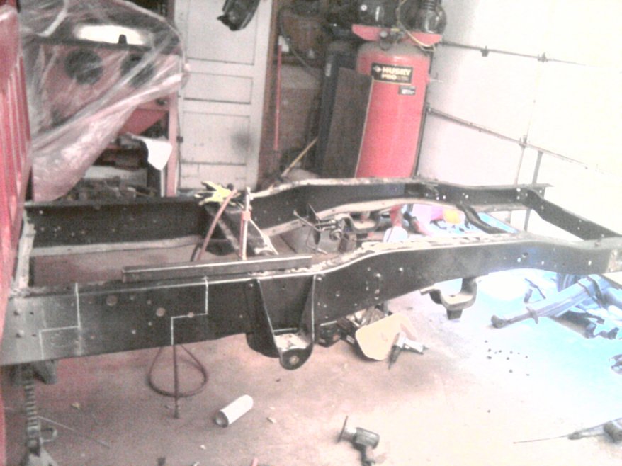

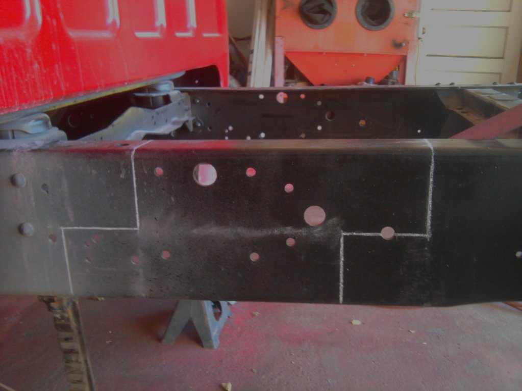

I could take care of it if you were in Houston. But if it helps, you need to cut 14" out of the frame in FRONT of the front spring hanger, and cut 4" out of the back of the frame.
When you make your cuts, do NOT cut straight down the frame, cut at angle in 2 spots of each side of the frame in front of the hanger.
Make sure you scribe reference lines down the frame before and after the cut lines, that way you have an accurate meins of keeping everything square when you weld it back togather.

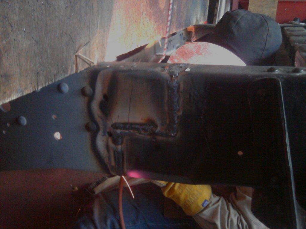

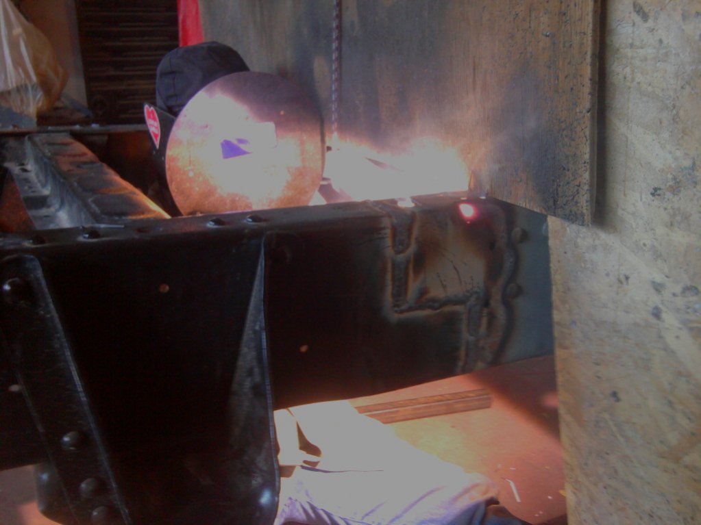

my crew cab cut to a short bed

Ya he welded mine front an back of the cut, ground the inside down so the plate would sit flat an then welded all around the plate. I had plates for the outside to but he said they weren't necessary.
Like I said he was a Coworker at the time an wouldn't give me a price. He told me to pay him what I thought it was worth. I think all total he was there almost 2 hrs an I had to pretty much make him take $60....
