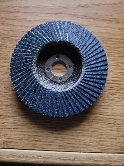

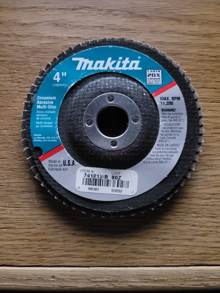

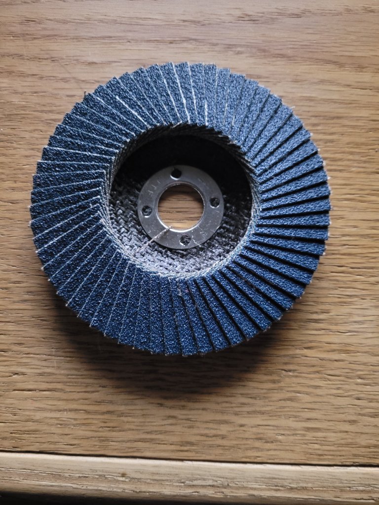

These work really well, come in different grit size as well as larger diameter for different size tools. They could be helpful to get down to metal in a few spots so you have a starting place with the media blaster. Powder coating and rubberized coating are not easy to remove with media blasting unless you use a chemical to destabilize the surface, or something abrasive.
media blasting can bounce off certain finishes like Powder coating and rubberized paints unless it is fairly aggressive in grit and hardness which is really hard on sheet metal. If you loosen the finish first you can work from the loose areas to remove the finish. Trying to blast through the finish as a starting point is slower than finding the edge of the finish and working from there. I used a sand blaster to remove powder coating from a few small motorcycle brackets, barely took off the shine and didn't come close to removing the finish, had to soak them in acitone to loosen the finish so I could blast them clean.
Removing paint is easy, other finishes make you work for it, especially if the product was applied correctly.
