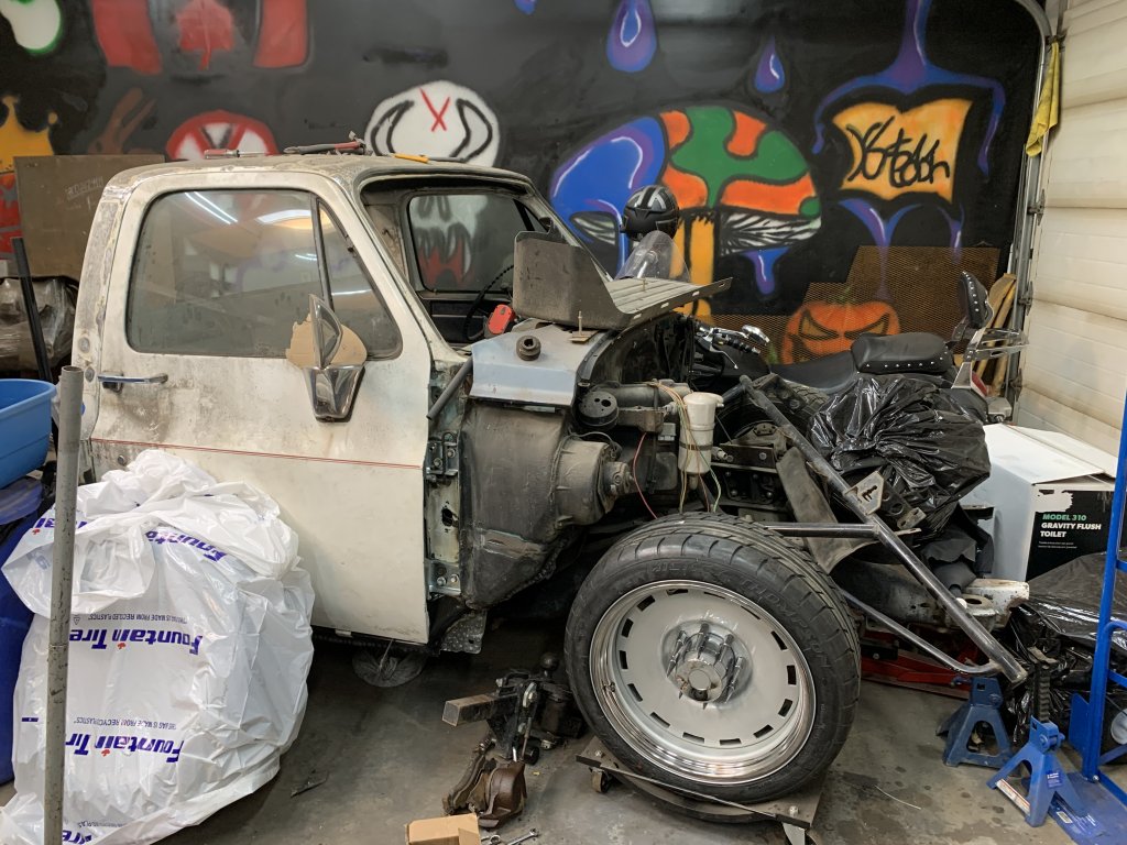

It’s not impossible though, try DSW Delray, just installed this one today

Thanks for that, had no idea they were available in 8 lug
