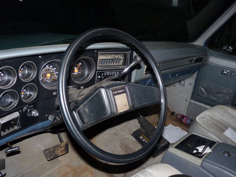

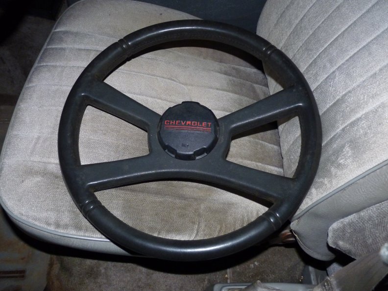

anyone know how to replace the standard wheel with the sport style steering wheel?

u need a steering wheel puller and the rest is easy if you have some mechanic skills

my issue is that the depth seems to be different because I pulled the old one and tried the 4 spoke and it wouldn't slide all the way on
anubisani
Apr 12, 2013
223
5
MIAMI, FLORIDA
SEAN
R/V 3500
454 TBI TH400 4:11 gears
did you use the bolt to send it all the way down

Yeah I tried sliding it on and it wouldn't go down far enough for me to thread on the nut

Pictures would really help with this. How much space is there between the steering wheel and the top of the column? If its not touching you may have to just give it a few love taps.
cobra20
Oct 16, 2014
231
5
Portland, Oregon
Hans
1991, 1974
V1500 Suburban, K5 Blazer
5.7L
give me a few minutes to get my old one pulled off again
cobra20
Oct 16, 2014
231
5
Portland, Oregon
Hans
1991, 1974
5.7L
Well it wouldn't go on yesterday and it just went on now lol. Got to love how life works some times.
