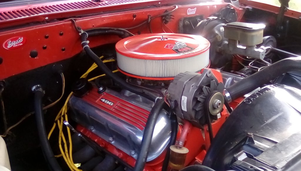

496
My 496 has a 3 core radiator, direct drive fan, full shroud and runs cool as a cucumber.
