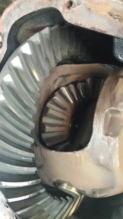

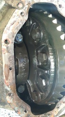

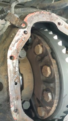

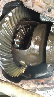

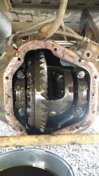

I just pulled the cover, I'm not to sure but I don't think it looks to bad? There didn't seem to be anything in the oil.. before and after I cleaned it all up.

Looks pretty good from here. You should spray everything down with a light coat of oil though. You cleaned it too well, it will start rusting really quick if left like that.

Ah okay! I think I'll just do wheel bearings and seals for now and see what happens. Still should I be worried about the rusted axle shafts? I don't have much extra money to throw around at the moment.
