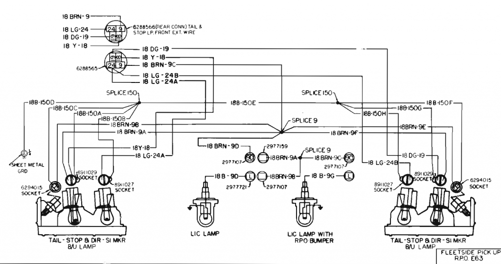

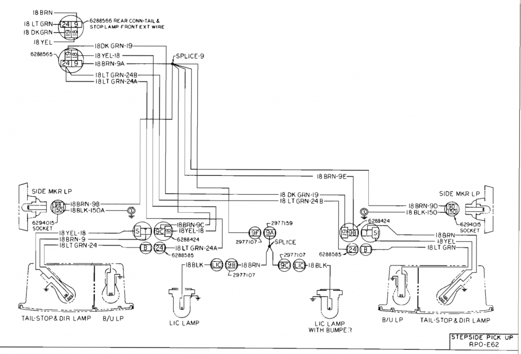

Can you be a little more specific? All rear passengers lights?
Stepside or fleetside?

78 short bed stepside.... Thank you guys and ty for the diagrams cuz sometimes I have a really hard time finding them I do have a book but sometimes they seem a little different
