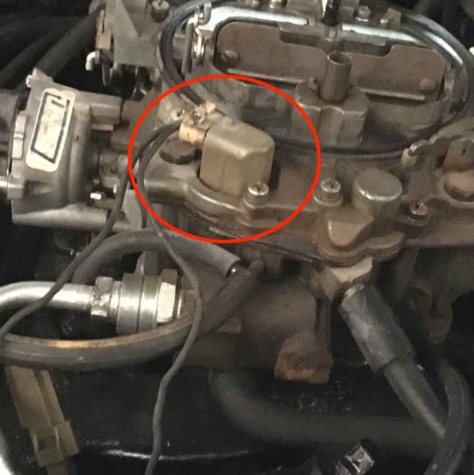

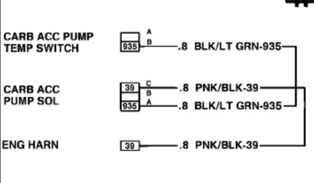

Quadrajet Dual Capacity Accelerator Pump Switch on my carb needs wired. So I have no carb accelerator pump sensor switch on my 1985 K10 305ci. I don't even know what it looks like. There is 2 plugged ports on my thermostat housing could that be where it goes?. Can anyone show me what one looks like? Part number? Where I can get one? I have the 2 pin carb acc pump connector, the connector in the engine harness but the other wire shows going to this carb acc pump temp switch.
Any help would be most appreciated.

update: The part number for coolant temp switch is GM 14080627. Of course it is discontinued...
