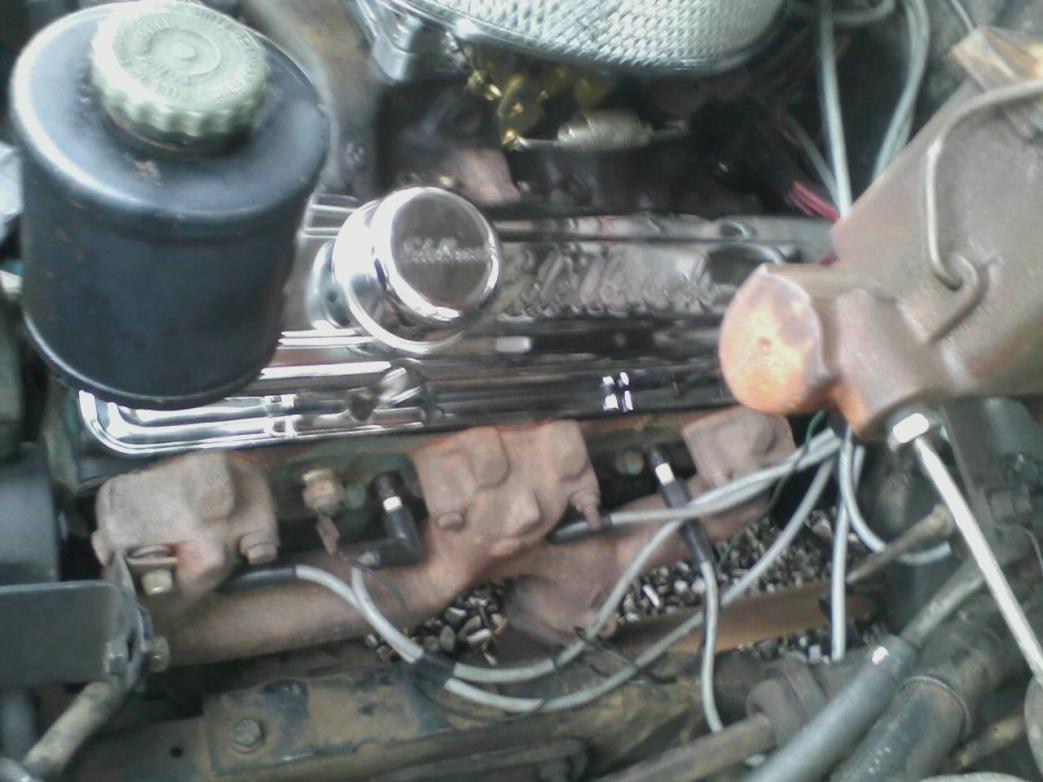

My push in Edlebrock breather is getting oil on the valve covers its not too bad but every week or so i have to take a rag and clean off the oil cause it gets visible.
Is this normal for the breather to do or is it a sign of something else.

Check your PCV valve, otherwise you could be having blowby, maybe dropped compression in a cylinder or 3.
