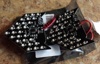

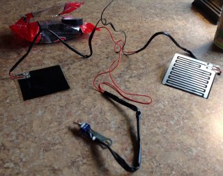

I went on ebay and bought motorcycle handle bar grip warmers, and the sequential turn signal arrows. I also bought a set of power chrome mirrors. Total cost was around $140.

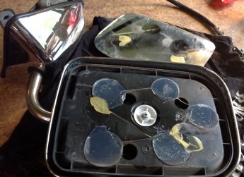

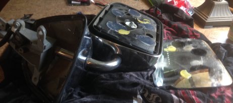

I used a plastic scraper to carefully remove the mirror glass from the tray.

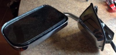

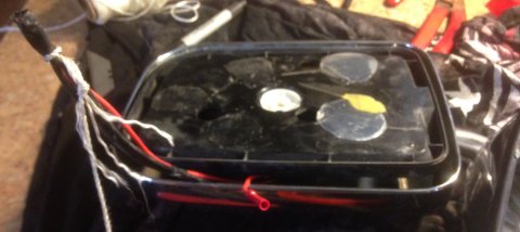

Remove the center screw so that way you can tilt the tray out of the way enough to run the wiring. Be careful not to move the tray too far as it is still attached to the motor (it is plastic spot welded). I then began running the wiring up the mirror arm making sure to allow myself plenty of wire to work with.

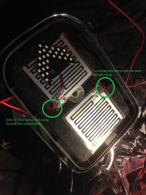

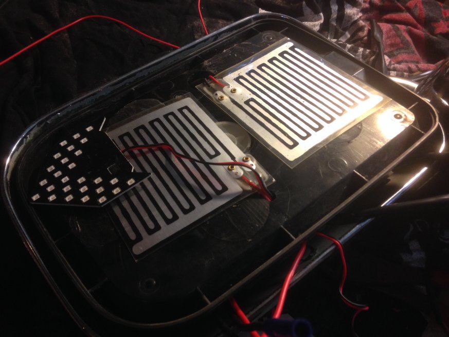

I then laid out the heat pads how I wanted then as to allow the wiring to be routed without causing any interference with the motor or glass face. I drilled a ¼” hole (as seen in the photo) to allow the passage of the signal wires and the outer most heating pad. Once the hole is drilled and your layout is how you want epoxy the heating pads in place and then allow them to dry. Once the epoxy dried I went ahead and ran the wires together for both pads and then connected the power and ground to the wiring I previously ran through the mirror neck. I used an old motorcycle battery to test to make sure the heating pads were working properly. I then moved on to the turn signal arrows, I ran the wiring through the ¼” hole that I drilled and then connected the power and ground to the second set of wires I can through the mirror neck. Again I bench tested them with the battery to ensure proper function. I then tried to center the arrows onto the plastic mirror tray and then epoxied it into place. I then retested to make sure it worked still. After the epoxy was completely set I then epoxied the mirror face back into place. You will notice a gap on the outer edge of the mirror where the signal arrows are holding it up slightly. I used black silicone caulk around the whole mirror face to fill that void and you don’t notice it when the mirror is adjusted properly for driving.

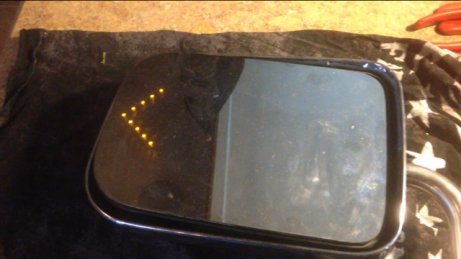

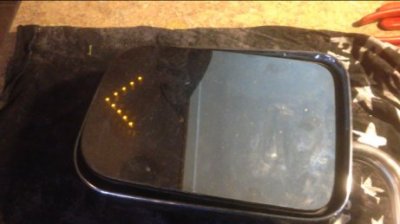

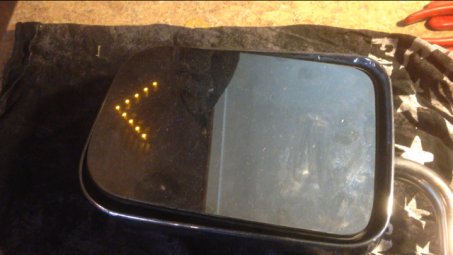

Like I said I have a video of the finished product but am unable to upload it. But here are a few still shots I tried to take while the signal was rotating.
