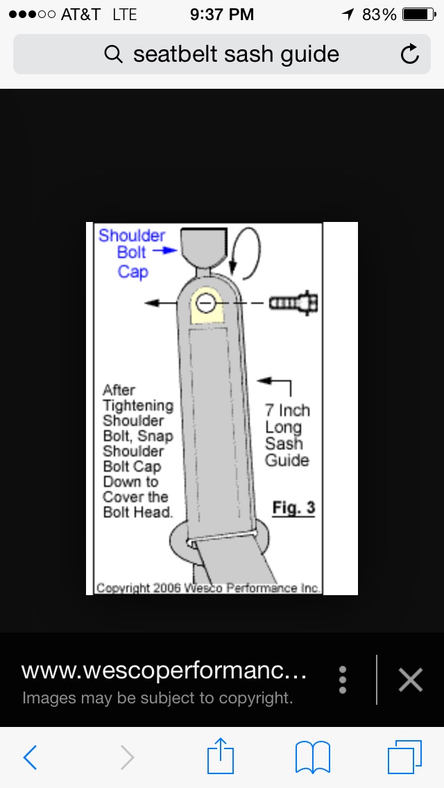

Ok I have a 1980 Chevy k10. it has bucket seats with the stock 3 point sealt belts. The problem is when my girlfriend is siting in the passenger seat the belt cuts into her neck/throat. To the point that if we got into a wreck would most likely snap her neck(yes she is short lol). Anyway tho I was wondering is there something out there that can make it so I can lower the mounting point for the belt like the newer cars and trucks or should I just raise the seat up with blocks??? Since I noticed were it sits on her I make her put the part that goes over her shoulder behinds her back. Any help would be greatly appreciated

How about a sash guide to drop the belt down.

Thank you! I will have to look into that for sure.
You could make one from some stainless flat bar or painted carbon steel.
