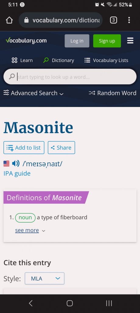

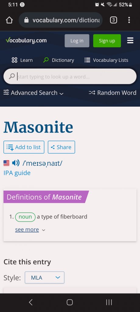

Masonite. That's a fun word. Way better than cardboard.
Not to be confused with the ancient free and accepted Mason ,of course.
