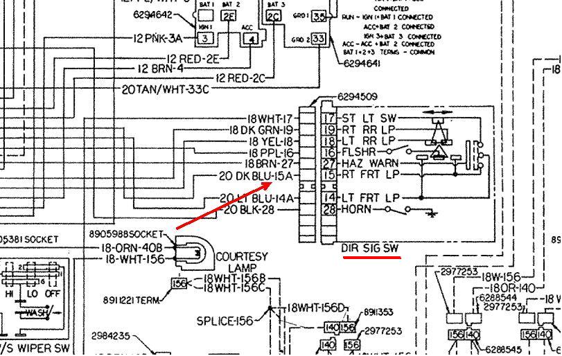

From what you describe, the most likely cause is the turn signal switch. You can check that switch using the connector to the switch at the bottom of the steering column. There are many more places it can fail so you need a wiring diagram and a test light or meter.

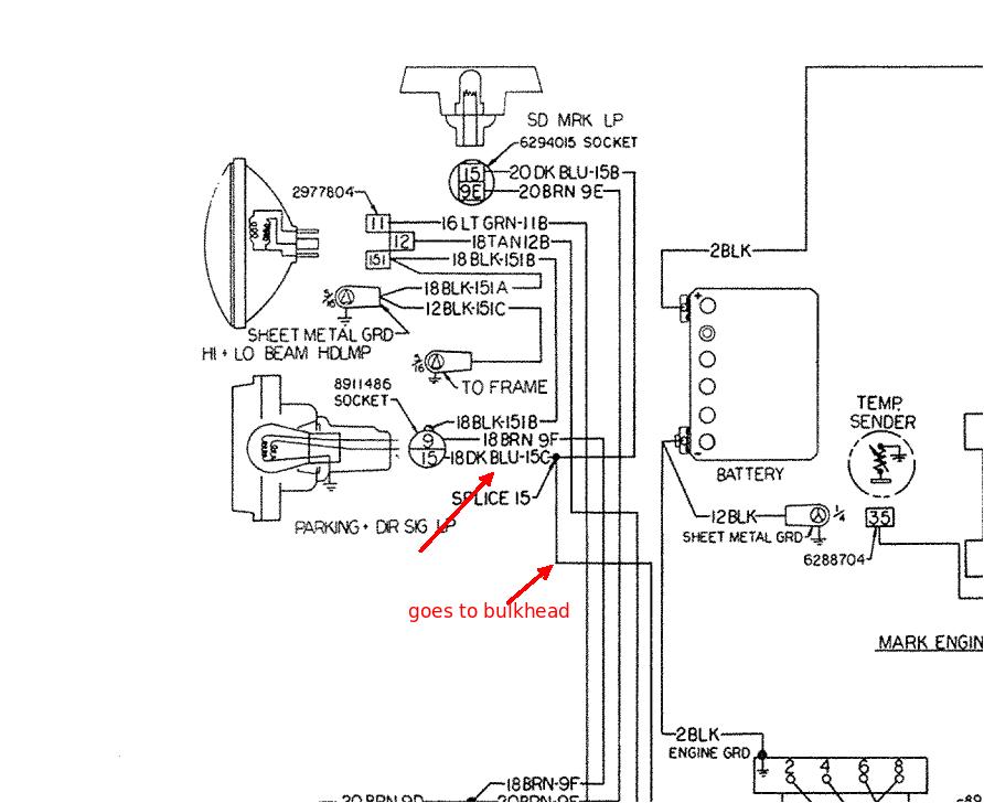

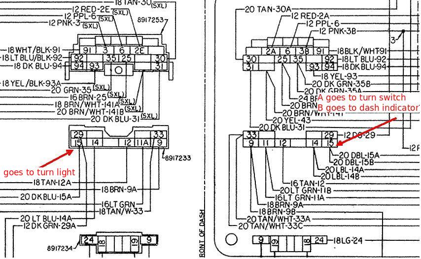

Dark Blue-15 wire. If I remember correctly (not home currently). Comes from turn signal switch and runs thru bulkhead to right front turn signal. Could be bad turn signal switch or something with DK BLU- 15 wire or it’s connections
Does the dash right turn indicator work? If it does, problem is probably after bulkhead. If it doesn’t, problem is probably before bulkhead(such as turn signal switch).
Jgonick
Jan 12, 2017
448
574
West Texas
Joel
Yep- DK BLUE-15
side note- always double check bulbs are good and you are using the correct bulbs. Front turn signal is a double filament bulb.
