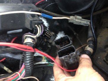

Here I removed these two small connectors from the bulkhead connector. It looks like front brown running light wire is in one harness and rear brown is in another. I pulled my h/l switch and the fuse still popped. So now my bad wire is somewhere between the h/l switch and the bulkhead connector OR could it still be that black roof marker lights wire that is on the h/l switch right next to the brown running light wire?
Also I have a second brown wire sharing the same connector in the h/l switch. It runs up into the driver door area and quickly joins a orange wire (with a brown stripe I think)
