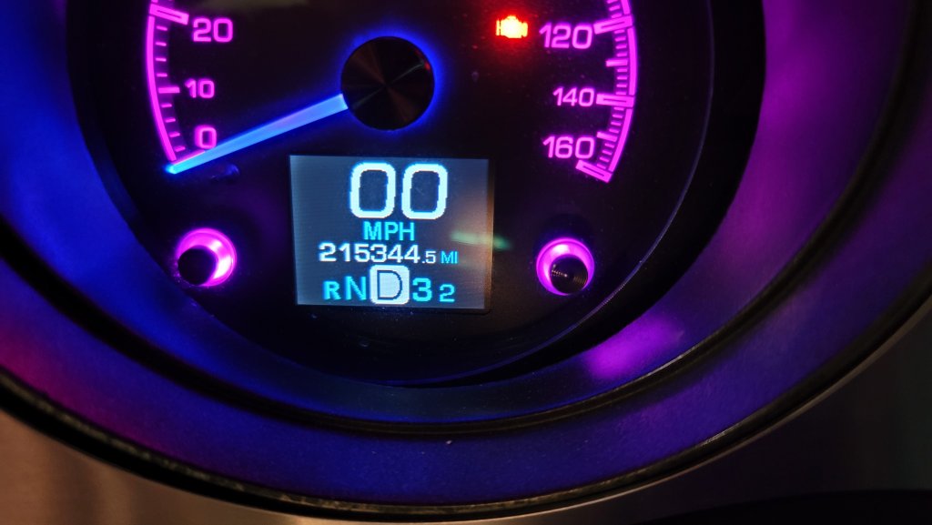

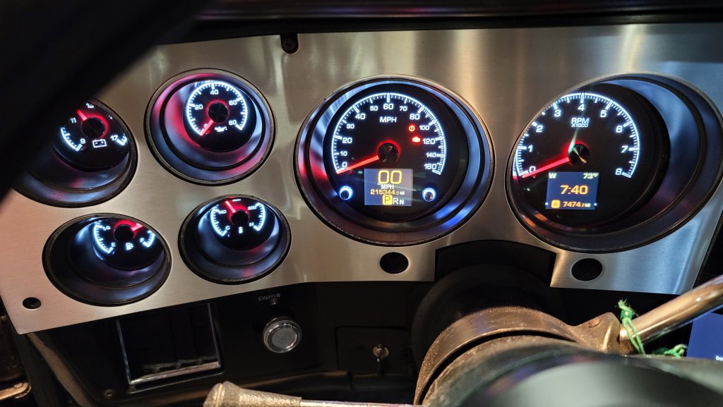

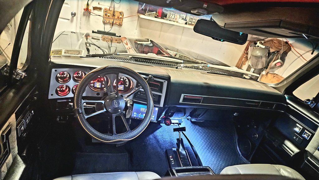

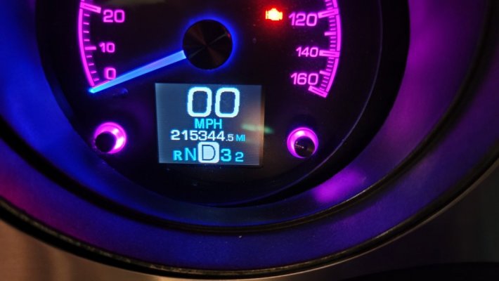

I went with the dakota digital and couldn't be happier with them overall. Plus they integrate well with the LS engine ecm by reading OBD2 data. Displays stuff like gear selection,trans temp,inlet air temp,4x4&low range indicators. Not to mention i can set warning alerts for volts, temp and oil pressure.
Combined with Bluetooth and all the color settings it's just fantastic really.
