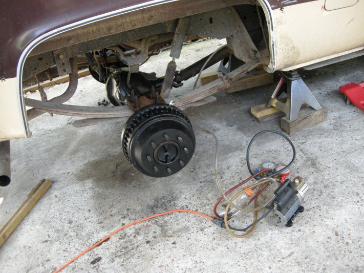

(My level of mech knowledge is mid-level, not a total newbie but nowhere near expert. (Just finished rebuilding-installing a 9.5", 14 bolt, semi-float, posi; that went pretty smooth for me. Used my own rednek strategy for brake bleeding, combined AC vacuum pump with Gatorade bottle and clear plastic hose fr HomeDepot, sucked out air out of brake system in a flash))
