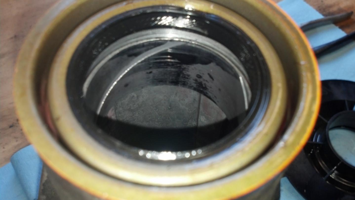

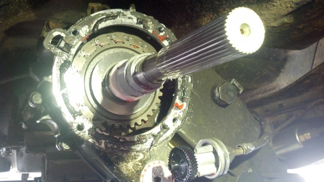

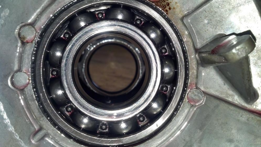

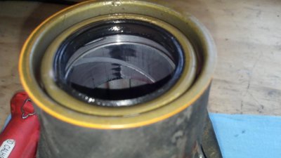

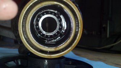

attatched are a few photos of the tail housing. I bend the rear seal being stupid just now :crazy:
The rear ouput shaft is suppose to be a little loose when the housing is off correct? I'm assuming the bearing in the housing is what lines it up for the slip yoke.
All i can see is some minor rubbiung on the collar just behind the rear seal. Thoughts?

With the tail housing off, try sliding the slip yoke onto the output shaft and see if it hangs up at all. If not, try to slide it into the tail housing and see if it hangs up. That would help track down which part it is having trouble going onto/through. As for the hole in the housing, if there's no other vent tube on the t-case that is more than likely going to be where your vent tube goes. Also I noticed your speedo gears on the output shaft, do you think that could have been interfering with the tail housing going on? Did you remove the speedo adapter before putting the tail housing on? Just throwing ideas out.

Slip yoke fits in housing fine. Slip yoke fits on output shaft fine. It seems to be that when the housing is on the shaft is only when the slip yoke is tight to get on. I wanna try without removing the speedo drive gear from the shaft.
