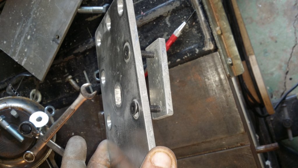

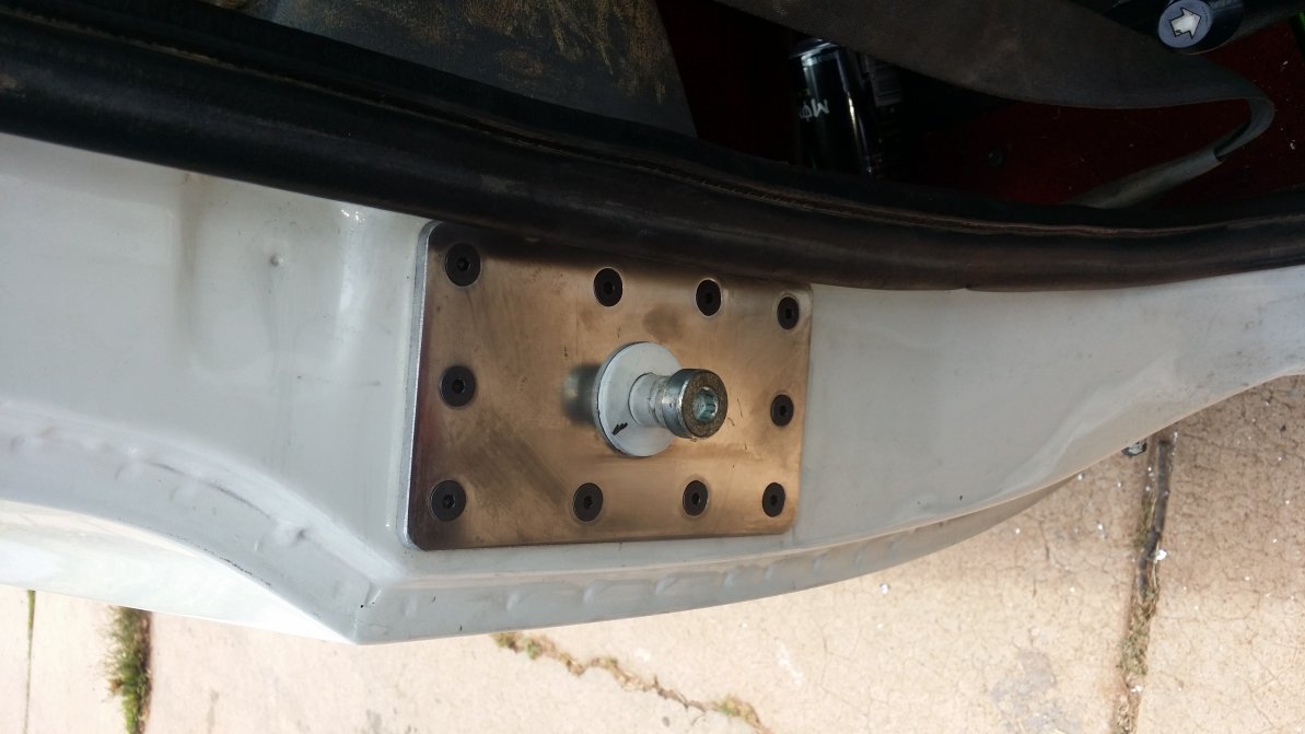

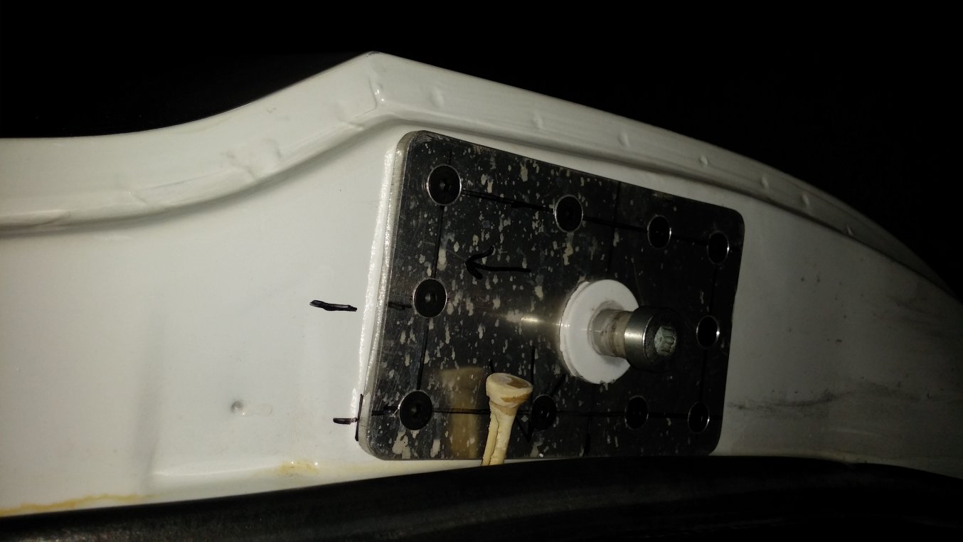

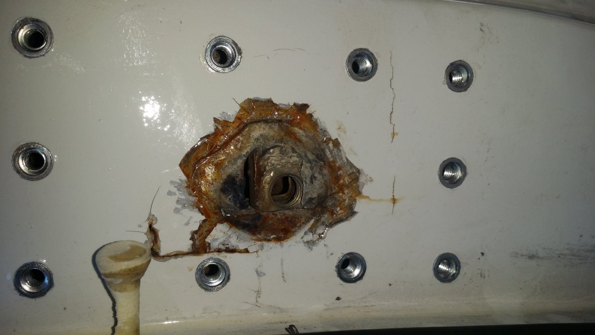

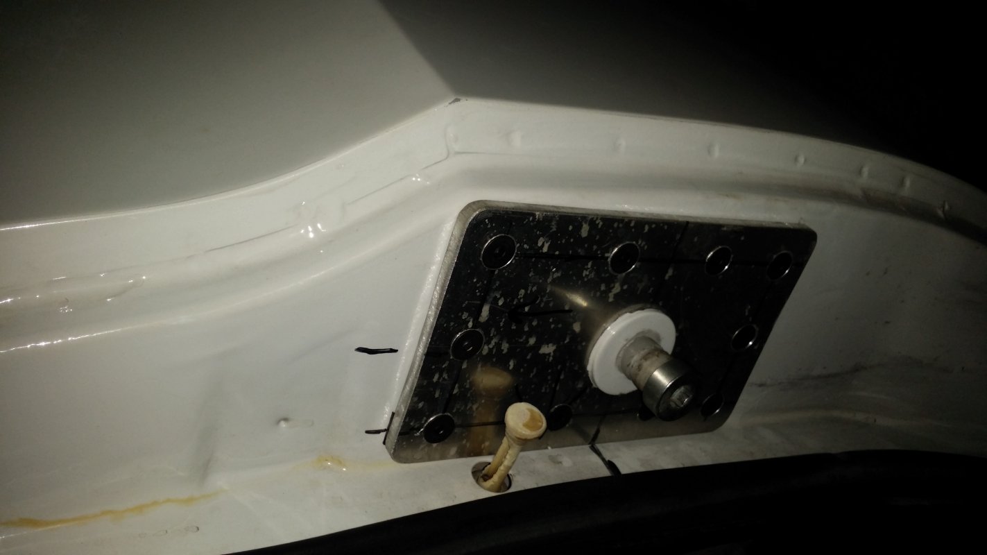

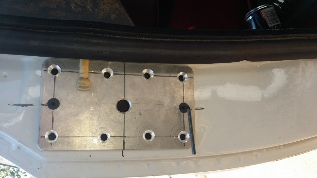

This is my fix to the cracked out door striker problem. About thirty minutes to make here's a few pics. I still have the pass side to do so I'll take more pics when I'm making that one. Once done they will be polished and should look pretty good

Another pic

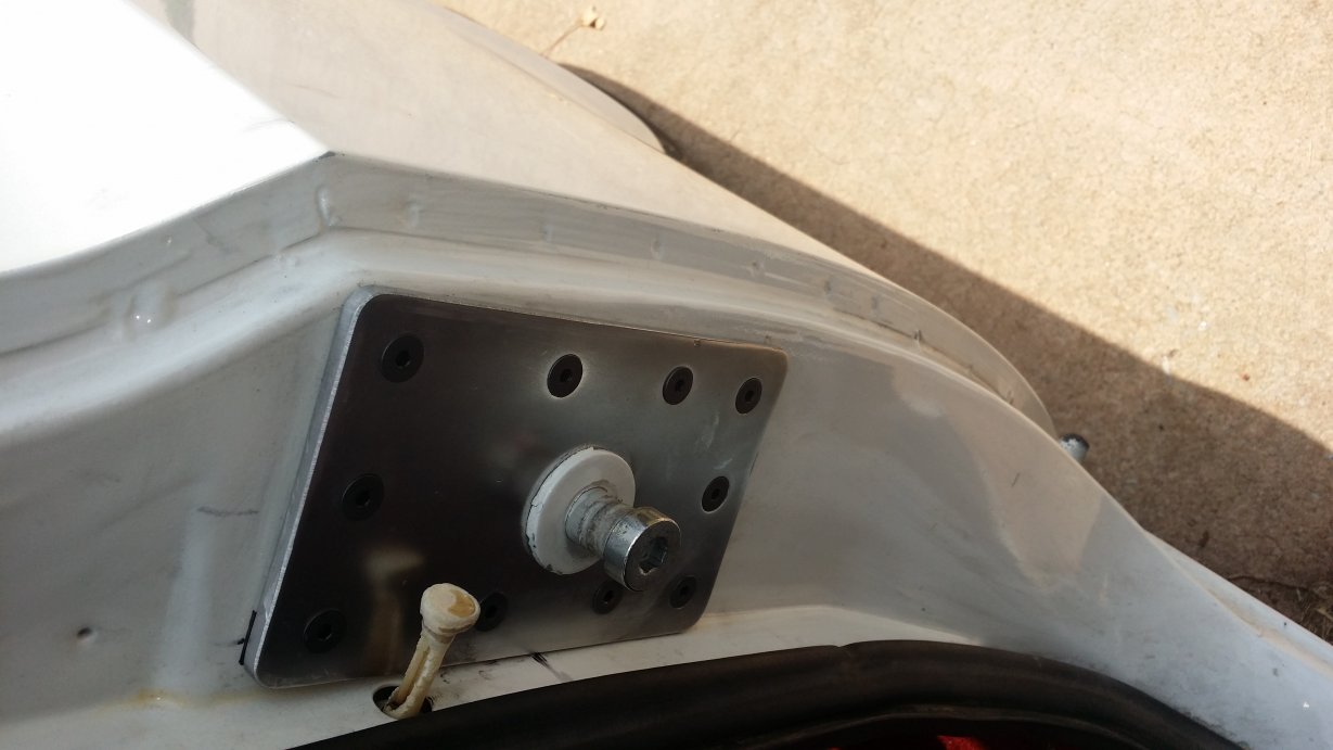

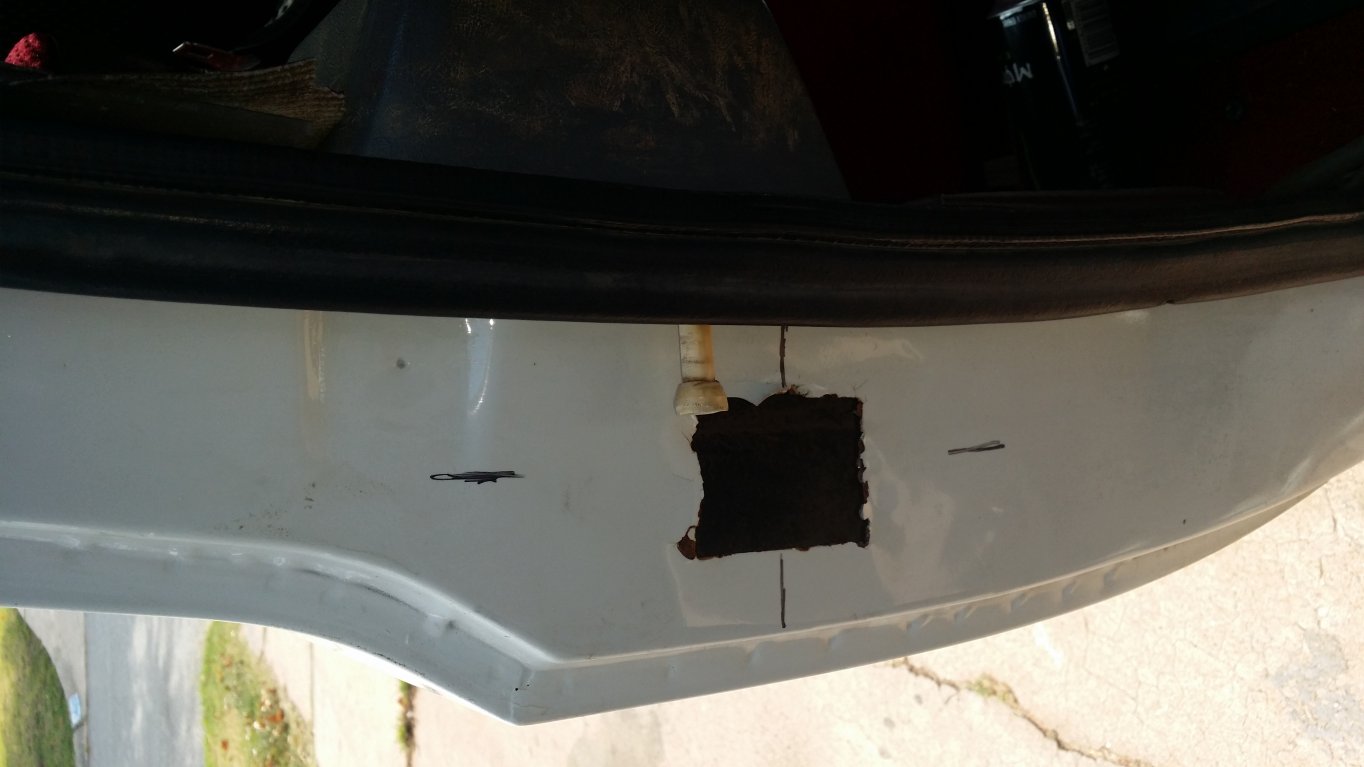

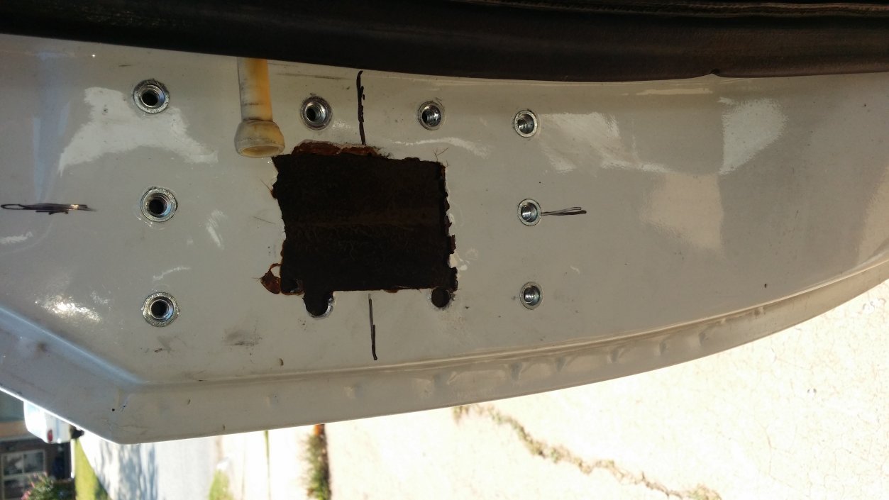

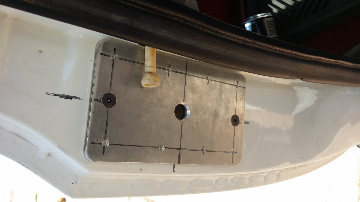

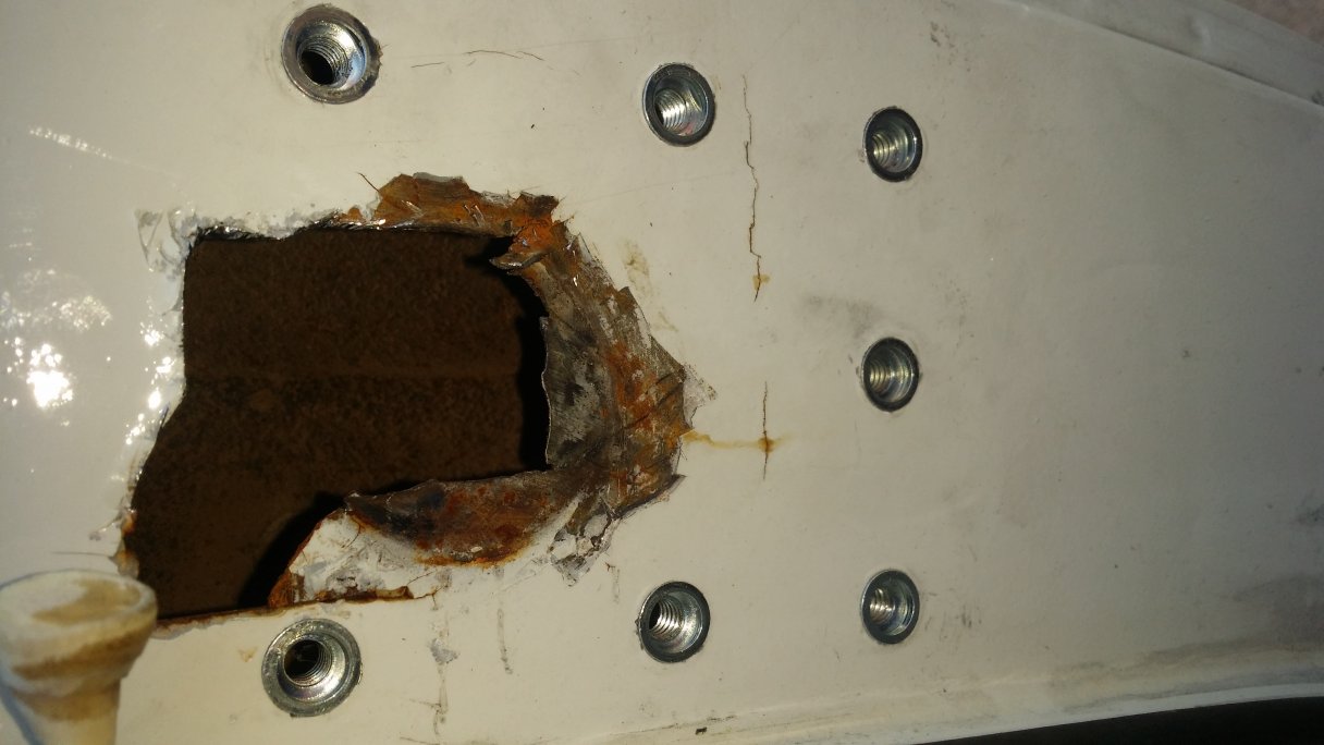

Here's some more pics. Pass side didn't go as easy as the driver side. Previous repair attempt was a hack job. That's why they cracked back out.

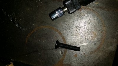

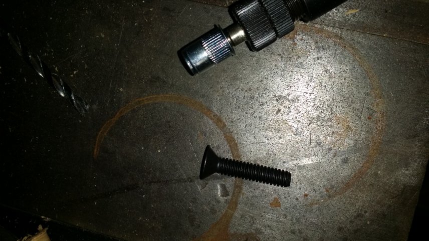

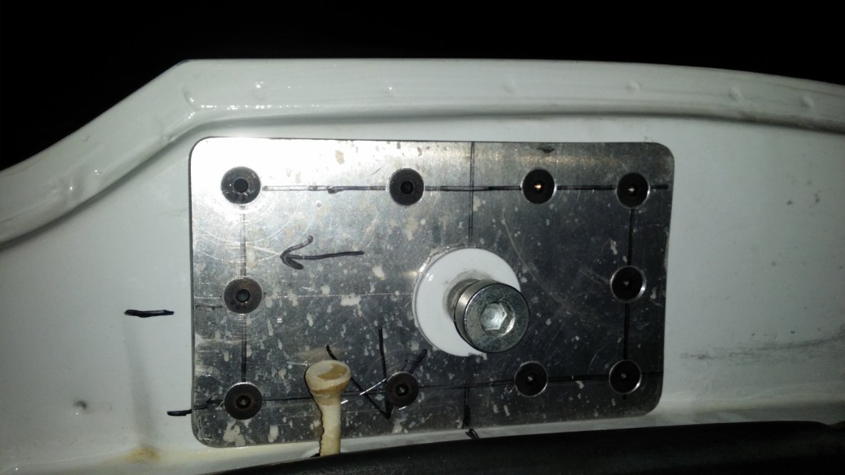

Both sides finished and doors shut perfect Fyi it wasn't hard to do but anytime u mess with countersunk bolts it's a royal pain in the azz to get right. Just be careful when doing your layout and drilling holes.
