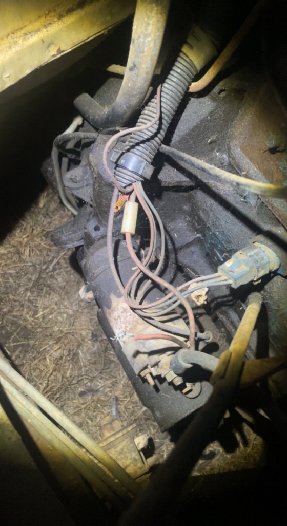

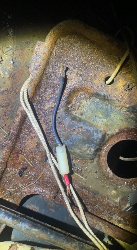

Believe I found my problem I found this spliced on not so good. What’s the best way too replace this do I need the whole knew wire or can I splice it with connectors

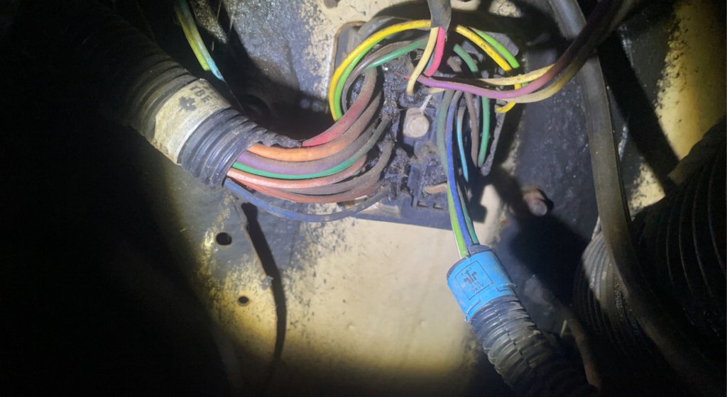

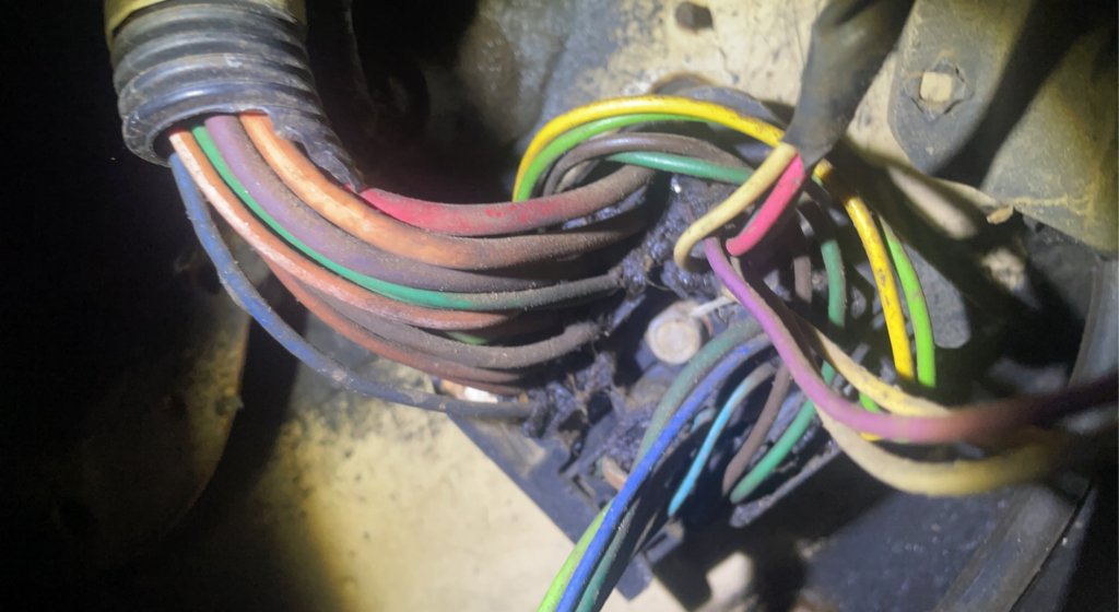

And also could that cluster on the fire wall being so dirty cause this problem
Your bulkhead connector on the firewall actually looks really nice. They’re all dirty and gross from the black gooey sealant they use.
Where was the one loose wire connected? Did it go to the bare wire coming off the starter solenoid?
