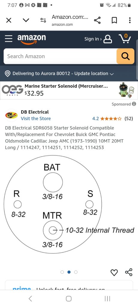

Short the starter solenoid,does it crank then. That 1 move tells a lot quick. I usually use a quarter or a screwdriver,short batt to S. Easy to spot,should be the only two posts with wires on your application. If it cranks,starter,battery,cables and ground are all okay. Then it has to be an ignition switch/rack,or a broken wire. If it doesn't crank, it is the starter it self,the battery,the cables or lost ground.
