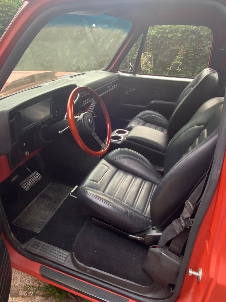

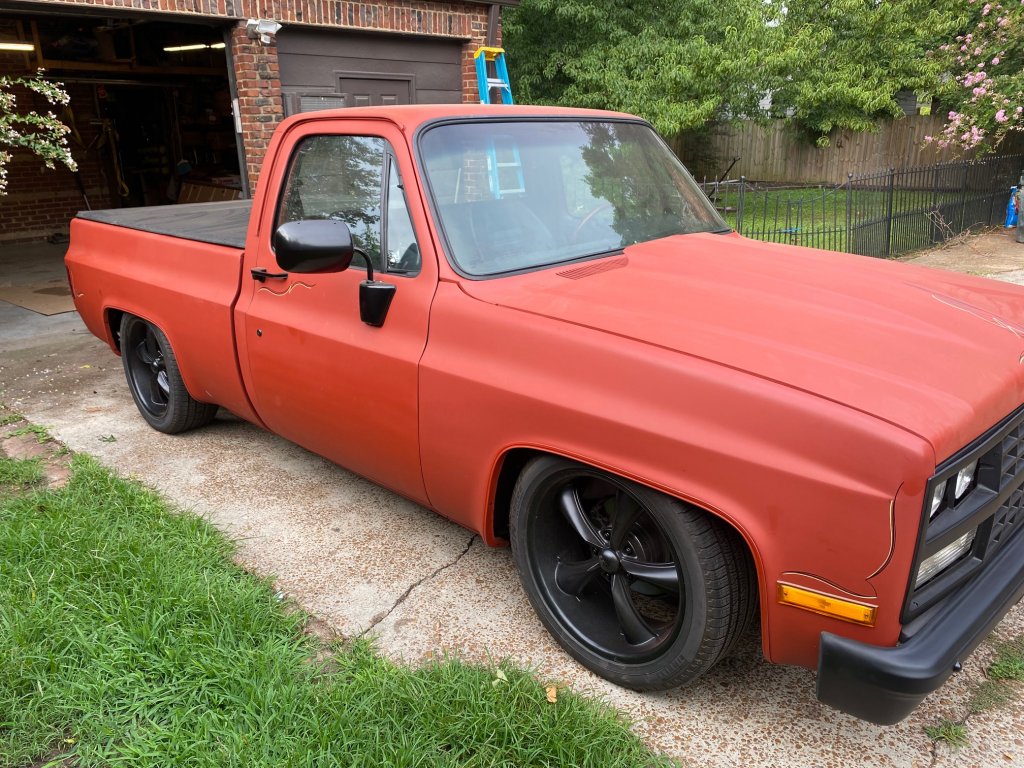

New to forum, here's my 81 GMC, 4 year build
Body:
- Custom matt paint w/black accents
- Old school pin stripping
- Cowl hood
- New poly cab/frame/bed bushings
- Bed liner
- HD bed/tailgate mats
- Rear mount gas tank w/filler in bed
- Custom tonneau cover
- 1980 Suburban core support, grill, lighting
- all new windows/doors rubber and weather seals
- Rear roll pan
Interior:
- TMI seats, console, door panels, dash
- Grant mahogany steering wheel
- Full dyna mat treatment
- New floor and rear cab carpet
- Custom floor mats
- Vintage Air
- AutoMeter Invision digital dash
- Electric windows w/man window handle controls
- Blue tooth stereo, custom speakers and sub
- 30% window tint
- Fuel injection and trans controllers in cab
Engine:
- LS 5.3 with 6.0 heads, ported/polished
- LSX 454 valve covers
- BTR Stage 2 cam
- FiTech fuel injection on Edelbrock Intake
- MSD LS controller
- K&N cold air intake with custom air cleaner
- Aluminum radiator with electric fan
Transmission/driveline:
- 4L80E
- TMI Trans controller
- 6 row trans cooler
- Custom driveshaft
- 3.73 positrac rear end with locker
Suspension
4 link rear with C-notch
- 6/4 drop with lowered spindles
- Bagged on 4 corners
- Air zenith compressor with 5 gal tank
- Air max manifold
- Air max 4 corner controller in cab
- Custom 4 corner/tank gauge in cab
- Tubular control arms front
Exhaust:
- Headers
- 2.5” dual exhaust with H-pipe
- Dynamax mufflers
- Custom exhaust tips through roll pan
Brakes, Wheels/tires:
- Front Disc, rear drums
- Electronic parking brakes
- Boss powder coated wheels 20 x 9
- Perelli Tires 245/45/20 (new)
