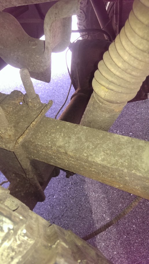

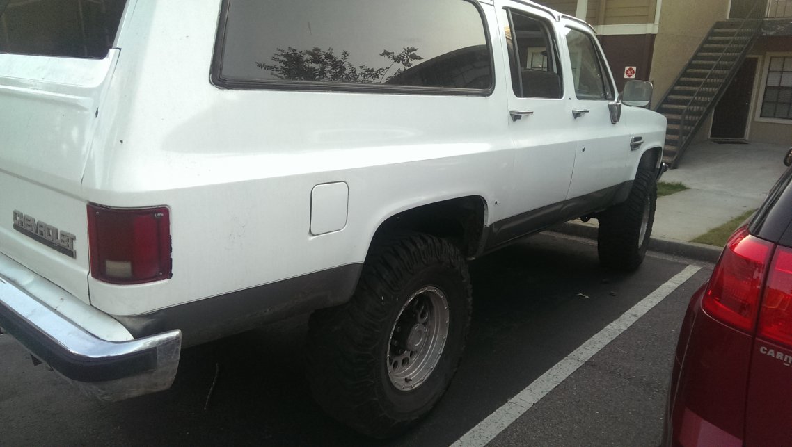

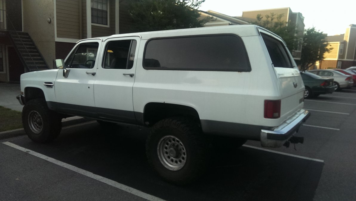

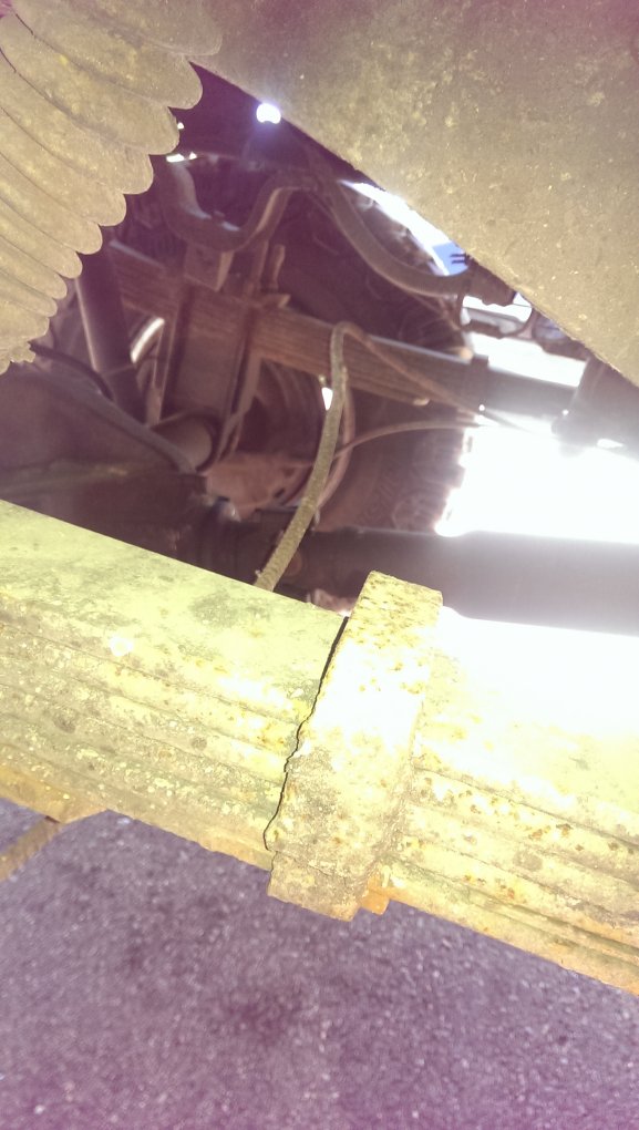

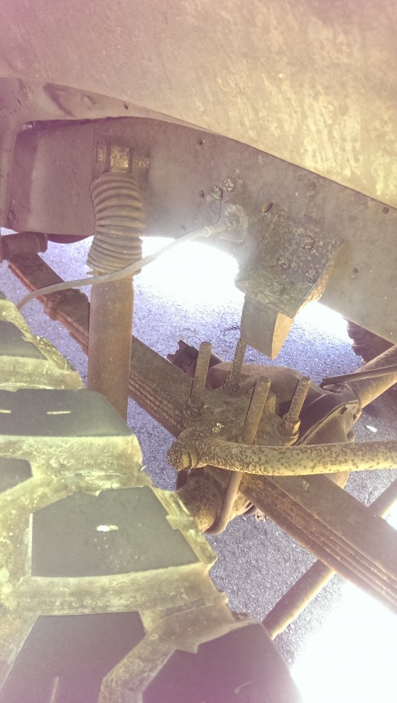

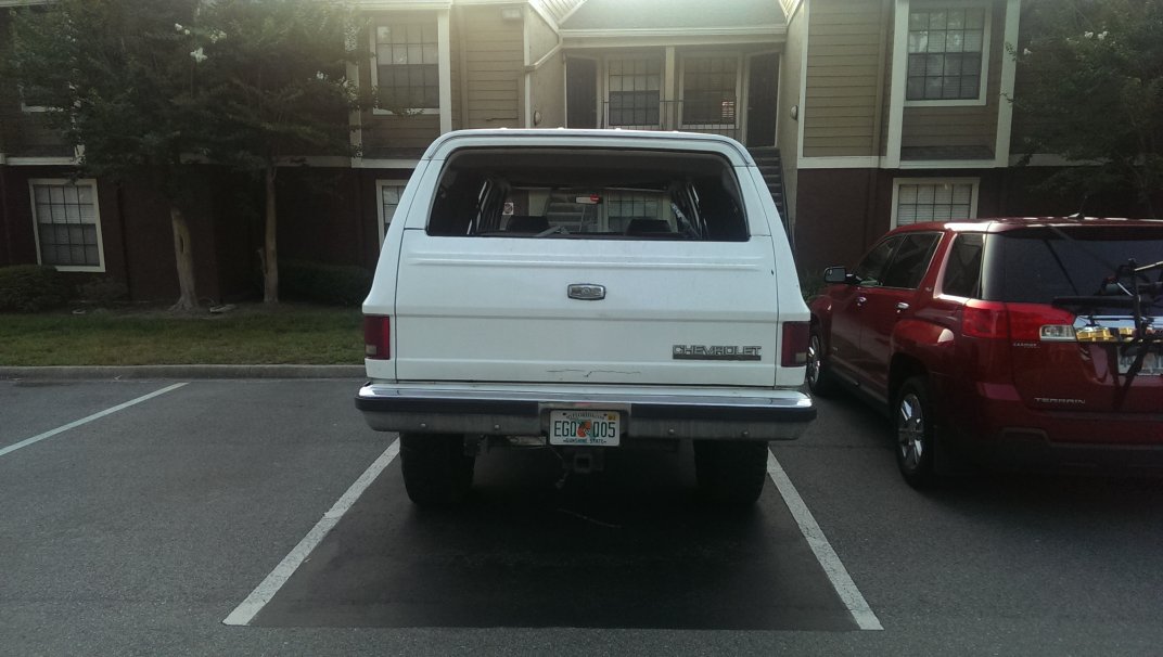

CHIEF
May 16, 2015
13
FL
Alexander
1988
V10
sorry if its hard to tell, first picture is front suspension, second is sagging side to good, 3rd is just sagging side, 4th is outside on good side, and 5th is outside on bad side.
here is a picture of the tilt from behind.
CHIEF
May 16, 2015
13
FL
Alexander
1988
V10
measured the blocks in at 4"s so any suggestions on rear leaf spring size? 5" spring lift with a 8" shock? what should I do for the front?

Hard to tell what you have from the pic's , are you sure you have a shackle flip on the rear , cant see the shackle's in your pic's.
CHIEF
May 16, 2015
13
FL
Alexander
1988
V10
One thing that would make the front ride a lot better anyway would be to do something with that sway bar. With a downwards angle on it right now when you hit a bump it tries to compress the sway bar. That won't happen. If it can swivel around it makes a big difference.
http://zoneoffroad.com/zone-offroad-products-suspension-sway-bar-link-chevy-gmc-blazer-jimmy-pickup-suburban/c5401
Ill definently have to look at that, because I do have the sway bar and its back breaking going over the speed bumps. literally throws **** in my trunk in the air. I have a set of headers for a LS1 back there and I might actually put them in my car because of how much the bang around sitting back there.
All the lifted square's I have owned I have ditched the sway bars on them all together and you are good to go.
Man , I would run an 8" on your burb , those things are long and they look hot with an 8" lift no matter what size tire you run.
You will want to check your rear leafs on your burb , see if they are 52's or 56's if you are going to get new ones
So it has a "factory" shackle flip. I may buy a aftermarket flip kit as the factory one is giving me maybe a inch maybe alittle less. My rear springs are stock leafs and have an added leaf from the looks to me Along with that 4" block. I was thinking 8" was good but thought 10" would be great if I do up in tire size. With that said 8"s of suspension with a shackle flip(roughly 1") and a 1" body lift as my body mounts are pretty shot would still get me roughly 10" im just worried ill do the 8" in the back and sit forward as the fronts are are kinda worn too. Suppose I wont be able to be a cheap ass this time around. Speaking of the front would 6" springs and 2" blocks be a good idea? I keep hearing blocks are the worst but granted pirate 4x4 is all about being MR OFFROAD of the year and well I just like to put around the beach.
