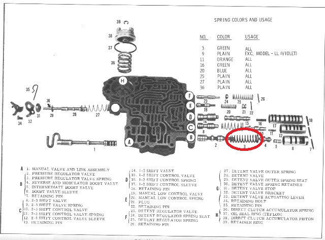

There is a spring in the VB, it has a large end and a small end, I put the ************ in wrong and toasted my directs. It wouldn't pull at all in any gear. I was being really easy with it though. I'll find a diagram and show you...

This is it

i dont think i did, i laid everything out, and swapped springs accordingly, it already had the trans scat kit in it, i was just refreshing the springs.
