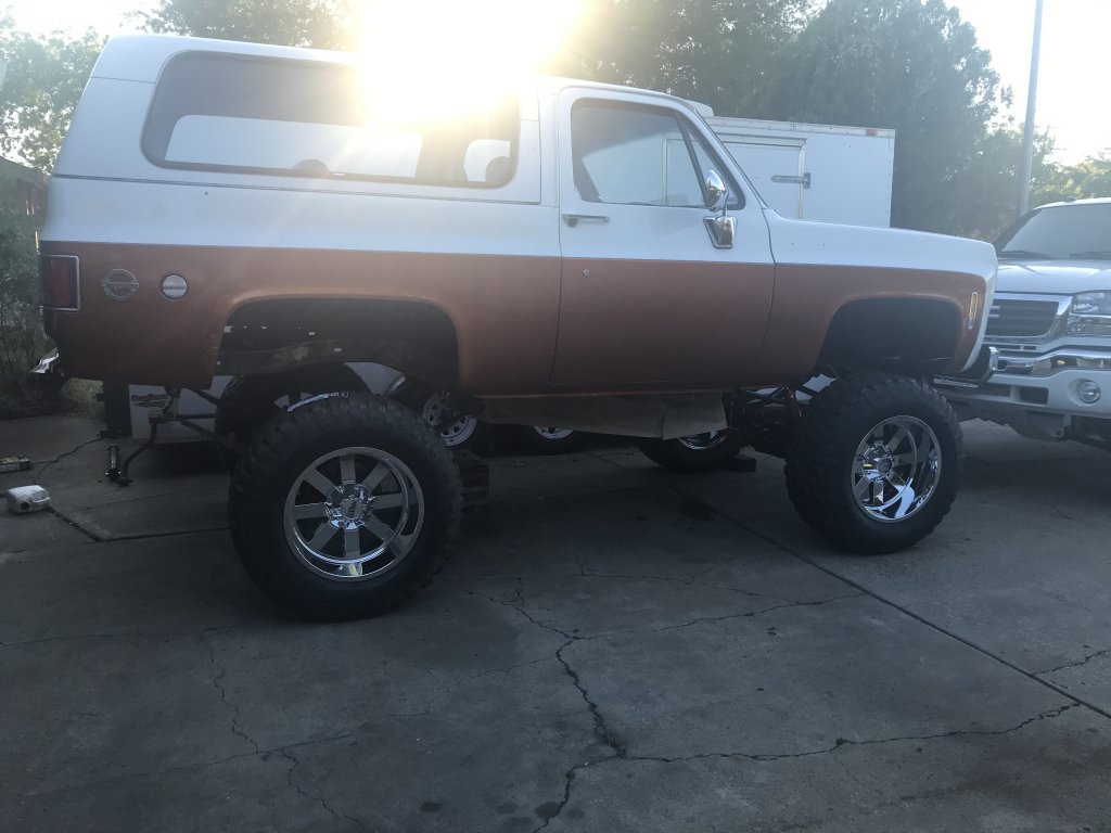

Hello,
Building my first k5 blazer. Heard alot of good stuff about this website.

Welcome to the site. Yes, post some pictures and create a build page for yourself, they make great reference items.

Welcome from Houston, and dayum !
How much lift on that ?

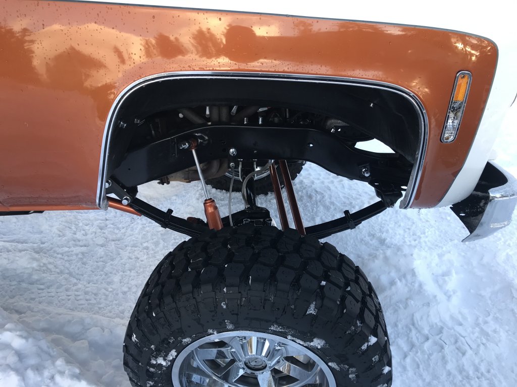

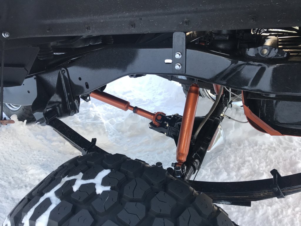

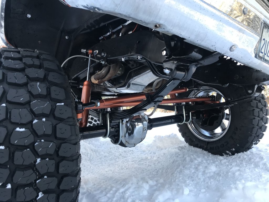

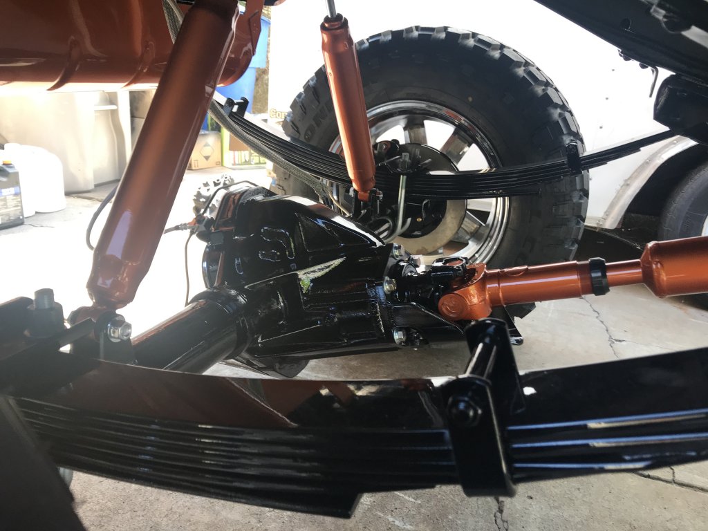

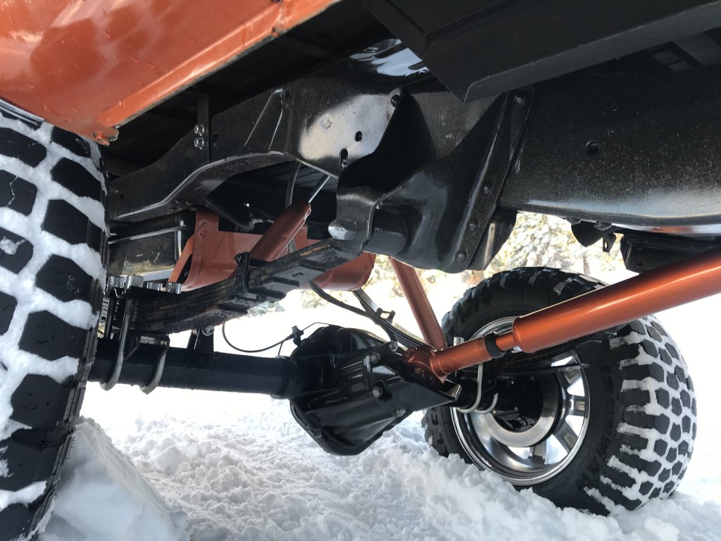

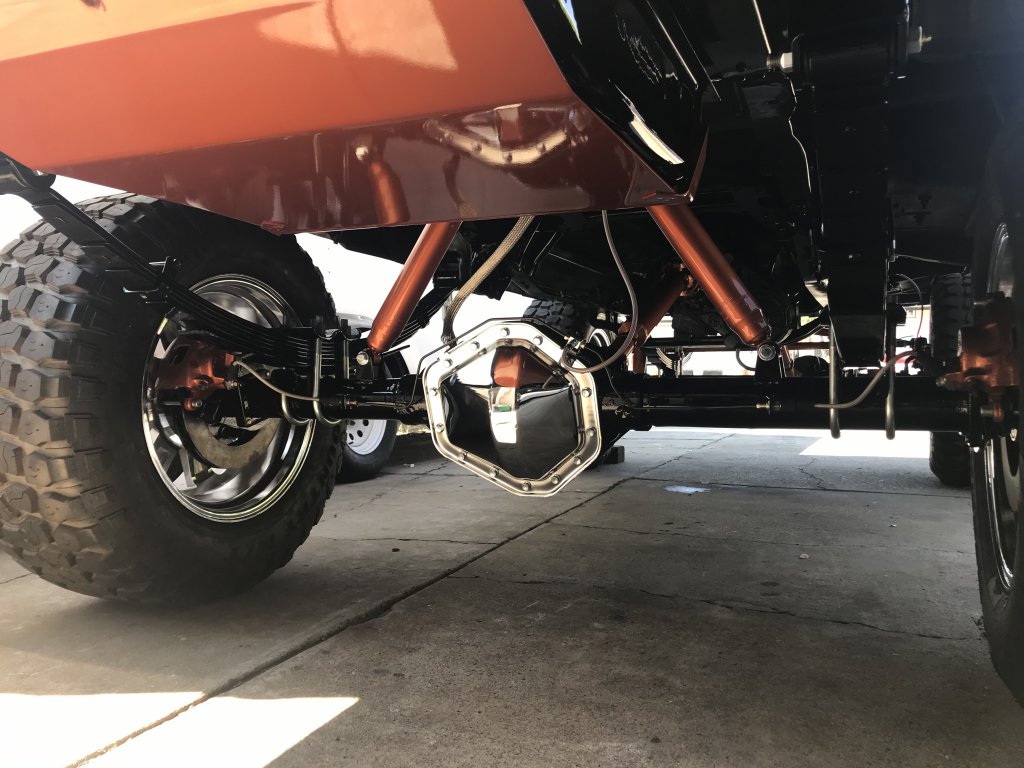

I did a front and rear axle swap. Went to a dana 44 front with a 14 bolt full float out of a 1979 k20. Did a high steer cross over with a 2wd gear box and a jeep steering shaft to get rid of the rag joint for the gear box. Did a rear disc brake conversion with portioning valve with master cylinder.
76 Blazer
Oct 28, 2021
7
13
Sacramento ca
k5 blazer
Here is some more pictures.
