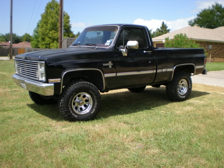

I assume you didn't do the lift yourself, so without getting positive confirmation from the person who did it, or getting parts numbers off something and cross-referencing it, you may never know for 100%. We can get you 98% of the way there I believe. It looks to me like a 6" lift. Having that big of a gap between the fender and top of tires is why I say that. And yes, you can remove your lift easily enough and install a smaller one.
The red truck looks like a 2" lift with 33's. Below is a truck with a 2" lift, 33x12.5 tires on 15x8 wheels. Very similar.

I think you could squeeze some x12.5's on 7" wide wheels, but if I am not mistaken the GM ralleys can be had in a 8" wide variety. I would find a set of 8" wide ralleys and call it a day. Does your truck have 6 lug axles?
That black truck is sharp, but it's not mine. I have that saved because I am hoping to move up to 33's in the future also. Welcome to the site, you will like it here. Good guys with great knowledge.
