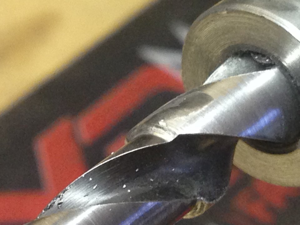

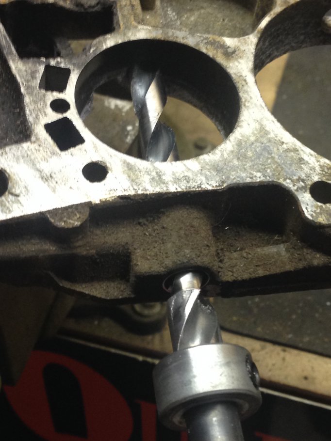

Not for reasonable price really. I use a special cut drill bit and set the depth. It has worked well for years, and I use it on every Quadrajet I build. Check with cliffshighperformance.com I don't think he list his bits on the site, but I do think he has them available to purchase. Cliff has good quality parts.

Here is what I use. It's the cut drill bit I referred to earlier. I cut the bore, and install bronze bushing on every build.
