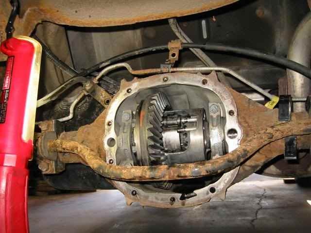

Hello all I k is this is for square body's but I was wondering if any one could help me with my s10 blazer it's a 96 I don't know if it has a limited slip in the rear but when I burn off and it hits posi and slides but then when I let off a drive it pulls left till I stop and if I turn right after the posi burn off the left tire cherps please help

Open glove box and check the SPID label for G80 for a GovBomb Limited Slip.

Ok ya I did that as soon as I got home and yes it does say g80 so what additive do I use exactly and any help with the vehicle pulling left after posi burn off

Well that's just gay now isn't it do you think itd maye help to put the additive in it I just changed the fluid it was old and nasty but oreiley said that you should never add limited slip additives but I called the Chevrolet dealer an told him the it has the g80 and the year an model and he said yea put the addative

Yeah, my Blazer doesn't have the G80. But you might get a little more out of it if you use the additive. Burnouts aren't good for a G80, I've seen some blown to hell GovBombs after burnouts, not pretty.

I had an S10 blazer with a busted G80 and it sucked. An open diff would at least transfer left/right but it seemed this one only put power to the left wheel. Better baby that thing or upgrade if you plan on continuing to abuse it.

I once had a G80 intermittently cause a mega pull due to a 225/75 tire on one side and a 235/75 on the other side.

A small difference in tire size isn't supposed to matter though, because it's not supposed to lock up at speeds over 25 mph. The slight difference in tire size "shouldn't" cause enough difference in axle shaft speeds to make it lock up at slow speeds either. Point was... it was a G80 that didn't function properly and caused a pull, lol.

We're not talking a big difference in tire size here. Sometimes there is more difference running two brands of the same size tire. Heck, even if both tires are the same, having a right rear tire that is simply worn down more could upset a malfunctioning Gov-loc.
