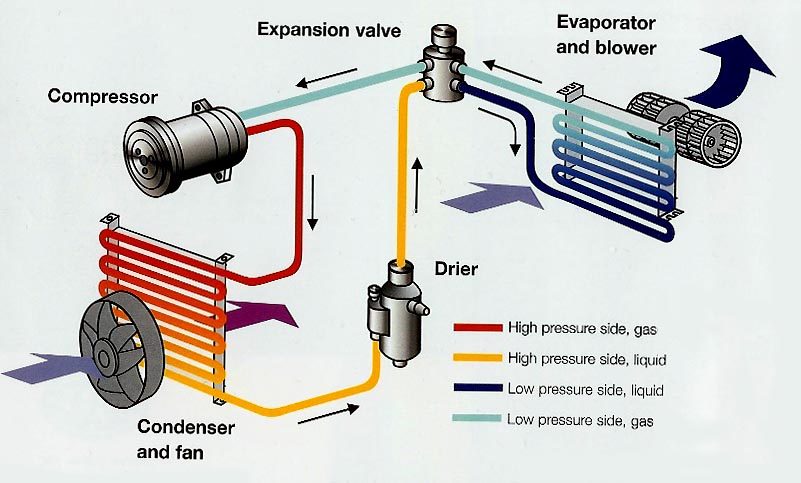

Power is supplied by the switch on the dash. This power goes through the hi and low pressure switches, either of which can disrupt the power supply to the compressor. The compressor is activated by supplying power to the electromagnet that is under the pulley. So why is your pump coming on by itself?
The "defrost" option on your dash also supplies power to the hi and low pressure switches.
Why? Because the defrost is using the A/C system as a dehumidifier in order to de-fog the windshield faster.
Solution: Put a simple toggle switch on the dash and run those two wires to either the hi or low pressure A/C switch so that you can manually disrupt the power supply to the compressor. This way you can run "defrost" without the pump coming on. This is the setup that I currently have.
An easier solution is to just unplug the wire that goes to the pump, or one of the pressure switches.
