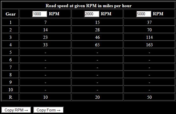

This gives you an idea of your road speed with 35" tires, 700r4, np208 t-case (assuming that's what you have, but for this, 1:1 is all that matters) and 4.56 gears...
attachment.php

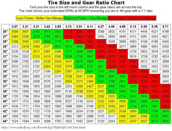

that build is pretty cool was reading yesterday. I also have a similar chart to the above hope it helps.
