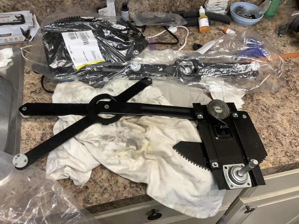

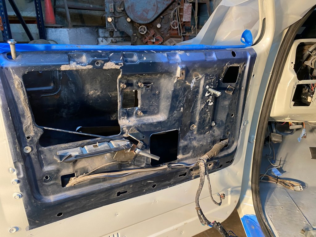

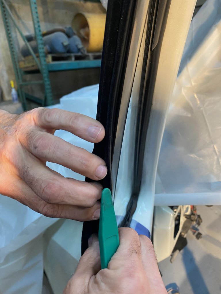

Got ours from classic. Look pretty solid. Swapping out electric for manual on sons rebuild. Fast shipping and in stock. I’ll let you know hopefully Tuesday how the swap from power to manual goes

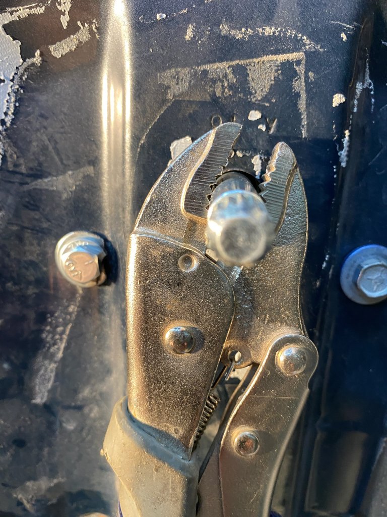

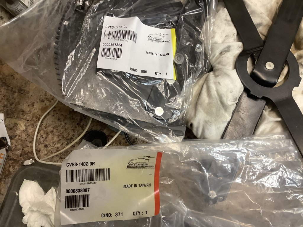

Let me update. We got ours from classic parts, not classic industries because they had both regulators in stock. The electric regulators had to bolts and two studs (in regulator) with nuts. When I tried to install drivers regulator, the two bolts I had from electric regulator (1/4 20) it would not thread into new regulators.
Go to Ace hardware and nothing SAE or metric will fit new regulators (go figure, stamped made in Taiwan) so now I have to decide to ship them back and buy somewhere else or just tap them out to 1/4 20… can anything just wok first time? So I retract my earlier support of classic parts.. stay away Jacob

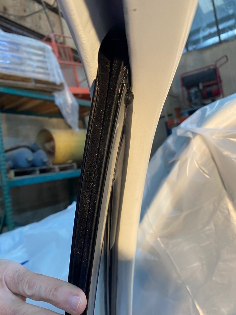

Jacob, the drivers regulator needed a tap to make them 1/4 20 and it went in like a champ. Had to lightly sand down the new rollers to actually fit into the channel’s and then it worked great. The passenger door regulator required no tap or sanding. We will tackle the passenger door Monday.

looks like a different year door but you figured it out :)
