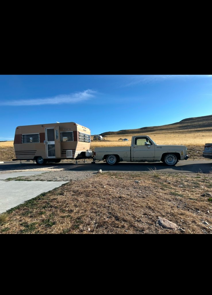

Anyone run Roadactive Suspension spring helper on a lowered square body? I have a small vintage trailer I pull and would like to reduce the sag on these old springs. My truck doesn’t sag much, but it’s enough that I’d like to level it out. The RAS kit looks pretty straight forward, and it looks like it would work with a flip kit. Just seeing if anyone has done this.

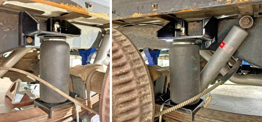

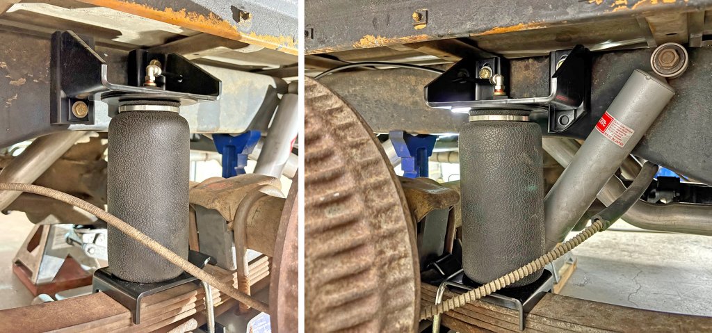

Never tried anything like that, I've always just put helper bags on everything. I used an NBS 1999-2006 (2007 classic) kit designed for use with a flip kit on those trucks. Just had to open up a couple holes and trim off one leg. Ran the lines back to the tag and just inflate them with a battery powered Ryobi inflator. Works great, I've got probably 25k miles on it now with no leaks
