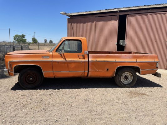

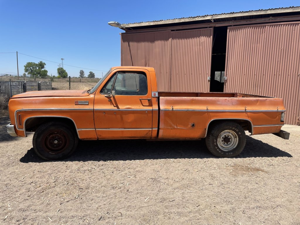

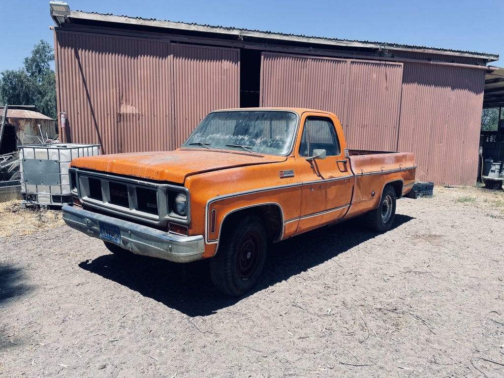

Here are some pictures of my truck. It is a 1974 GMC Sierra Grande. It came with a 454 engine and a th400 transmission. I am the second registered owner on this. I am from Los Angeles.

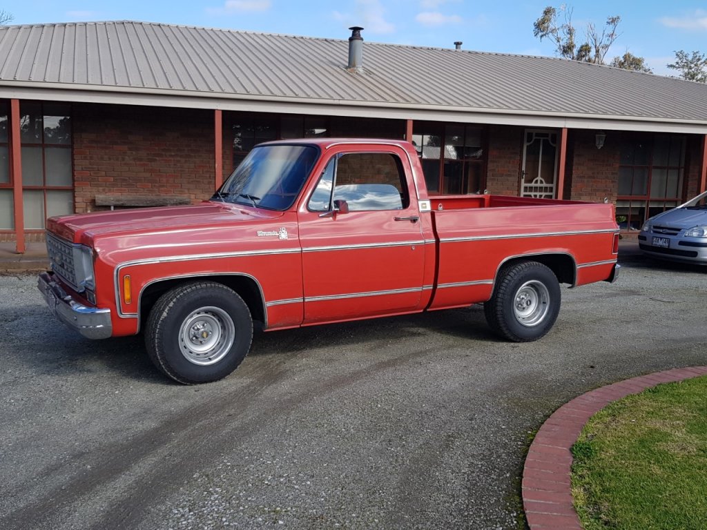

I'm a fan of the factory rally wheels, (I think that's what you call them) these are the 8" rims.

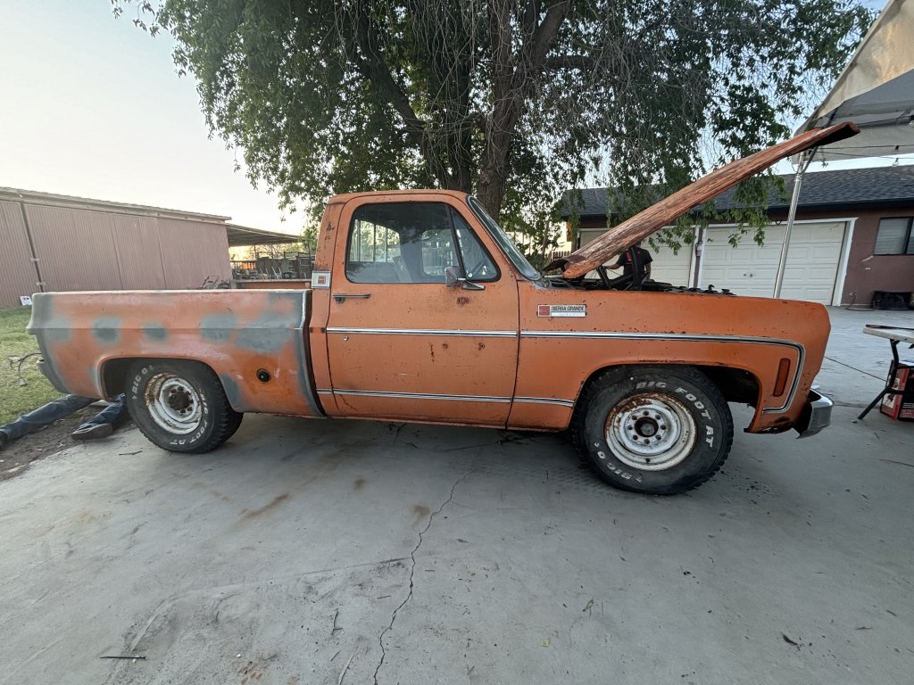

Hey guys,
Update on the truck after working on it on free times on the weekend. It is now a shortbed and lowered using the switch suspension drop kit.
