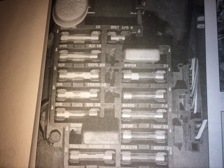

Hello, I have a 1978 chevy k20. I bought a bunch of different amp glass tube fuses. I am going to replace all of the old crusty fuses in the fuse block under the dash. The problem is is that not all of the fuses are their, some are not the right amp rating, and some of the stamped on amp rating on the plastic fuse block itself has worn off. I cannot find anywhere what each specific fuses amp rating is supposed to be. Does anyone have any pictures or info on what amp fuse goes in each slot. Thanks.

Or like this one. I think the other pic is of a pre 73 fuse block but not sure.
If this one is weong I can take a pic of my 78 fuse block later today and post it.

my fuse block looks like the first one. Thanks. Between the picture and the website that lists the fuses i think i got them all sorted out.
