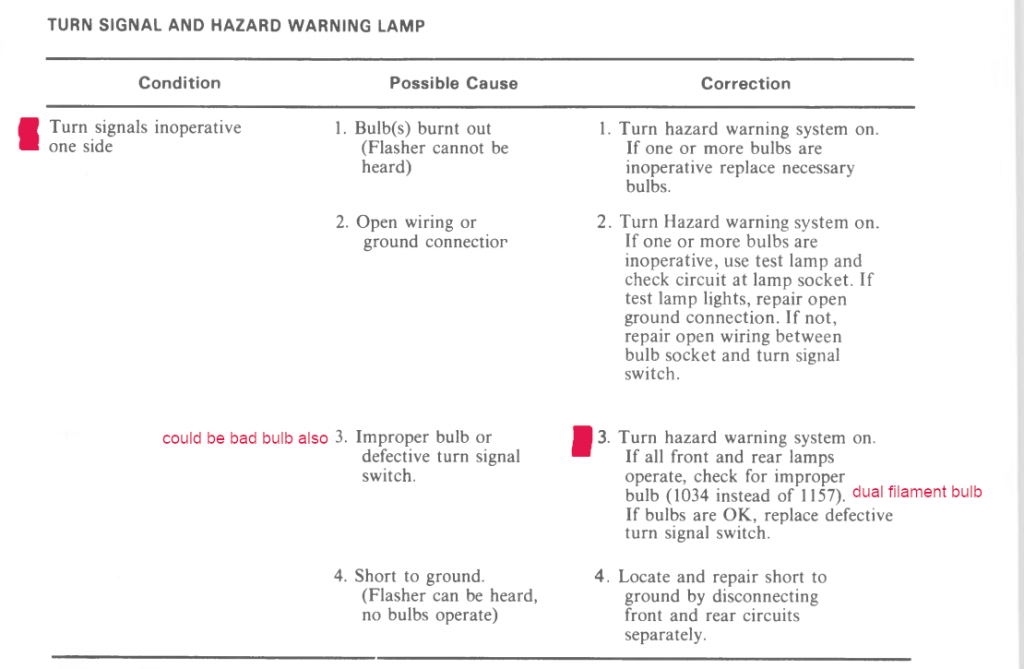

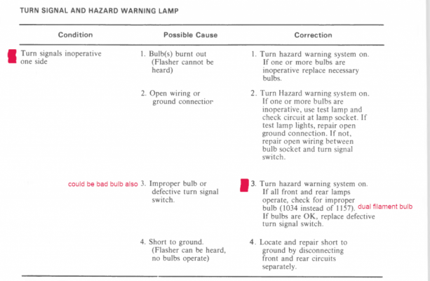

Help need advisement! HELP. 1978 GMC K15. Left turn signal when turned on only lights up on dash as a solid light, no blink. Both left side turn signals front and back do not work, Right side turn signal is good. No running lights either side left or right???? in the back of the truck. Brake lights work, Hazzard lights ( 4way flashers) work good. I'm a novice at electrical issue at best. Hoping for some info, so if I have to take it to a shop, I'll at least have an idea. appreciate y'all.
