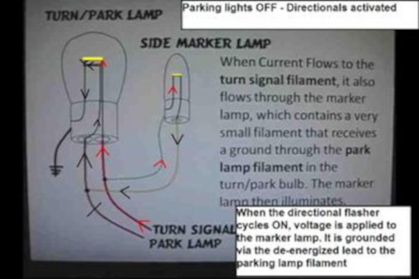

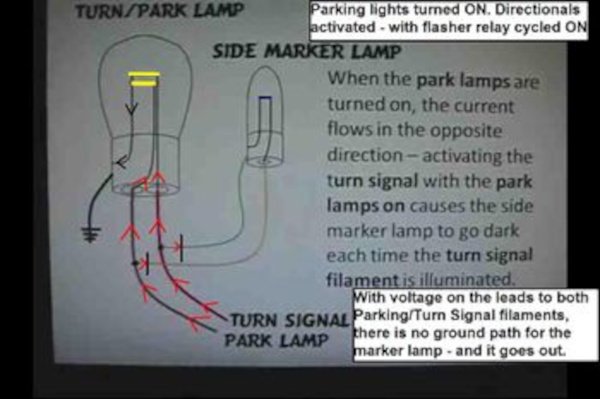

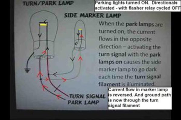

That is correct. The original side markers blink the same as the front signals with the headlights off. They alternate with front signals with the headlights on. With the headlights off- current goes through the (flasher) blue wire and grounds through the brown (through the dual filament front bulb)- they blink. With Headlights on- current goes through the brown wire and grounds through the blue wire (through the dual filament front bulb) for the parking lamps- however when you turn on the signal- it feeds current (flashing) down the blue wire- since current is coming from both direction (brown & blue wire) it causes the bulb to go out every time with the flashing current. Think of a garden hose with water coming from both direction- water will meet in the middle & not flow.
So when you add LEDs to that situation it gets confusing - LEDs only let current flow in one direction unless its been modified somehow.
Let us know what problems you are having with incandescent- if you go that route. Most light problems are usually cause by wrong/bad bulb or grounding issues.

Is this with LEDs or incandescent? LEDs get confusing like I mentioned- They typically only let current go through them in one direction. AND the front lights depend on dual filaments that lets the opposite filament being used act as a ground- which can also be problematic with LEDs. ALSO electricity looks for a path to ground and it can do some strange things if it finds one it isn't really suppose to be using. Is it doable with LEDs- Yes, but If you were having problems before with incandescent- you should get that fixed before moving on to LEDs. (my opinion)
also the brown split wire I have leading to nowhere from the drivers side marker light
For me it would be easier to tell with incandescent. If all your parking lights worked -I would say it was just added on- If they don't, we could trace where the wire was suppose to go to.
